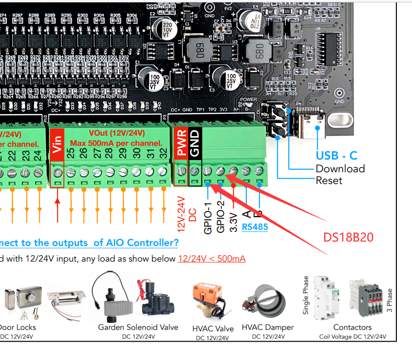

The ESPHome code shows Dallas on pin5.
dallas:
- pin: 5
update_interval: 60s
# Example configuration entry
sensor:
- platform: dallas
address: 0xec0921405caae128
Where does it connect on the board?
RE: KC868-AIO configure yaml for ESPhome - admin - 04-04-2023
see photo. there are two GPIOs use for DS18B20.
