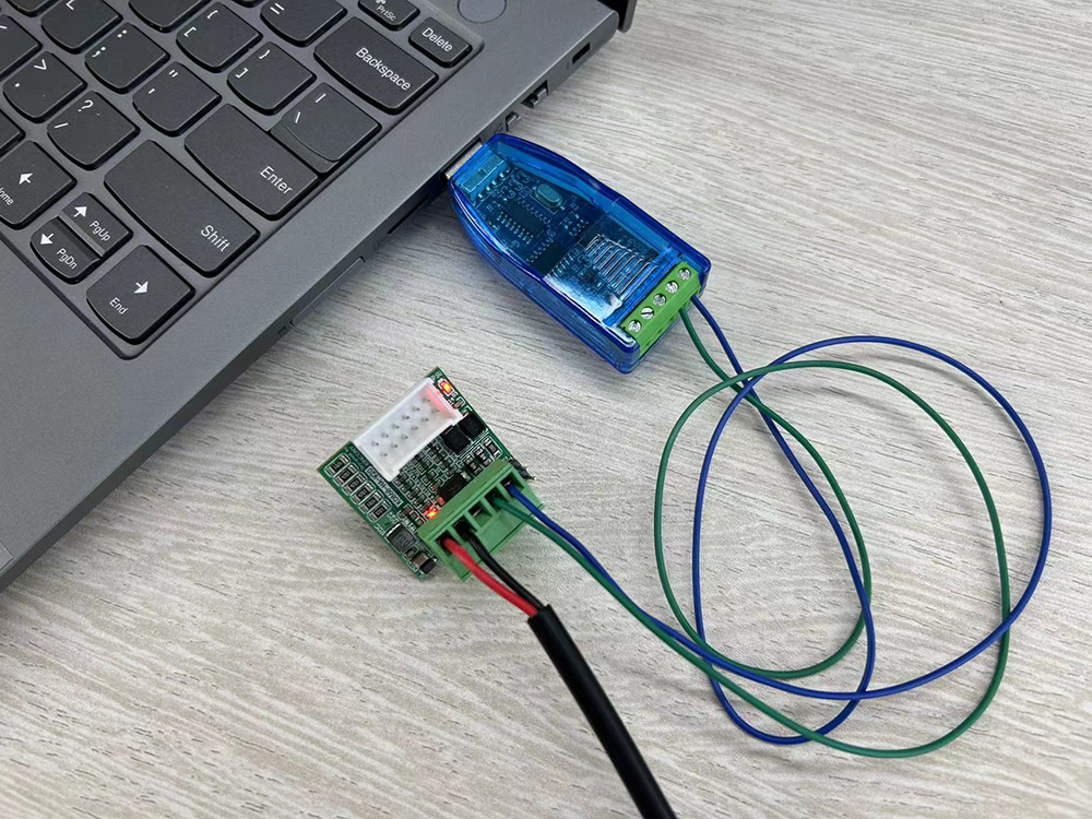

KC868-HA PC software V1.0.5.1011 - admin - 11-01-2023
make sure your computer have installed CH340 USB-RS232 driver.
