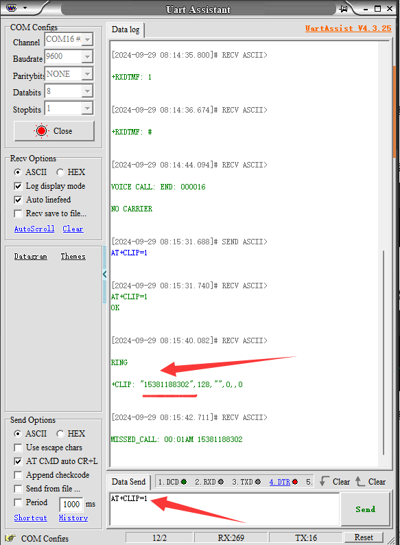

RE: how to turn on relay by SIM7600E 4G module voice call in ESPHome - admin - 09-29-2024
To identify an incoming call number on the SIM7600 module, you can enable the Caller Line Identification (CLI) feature using the following AT commands:
AT+CLIP=1
Then when RING will show the phone number, such as:
RING
+CLIP: "15381188302",128,"",0,,0
