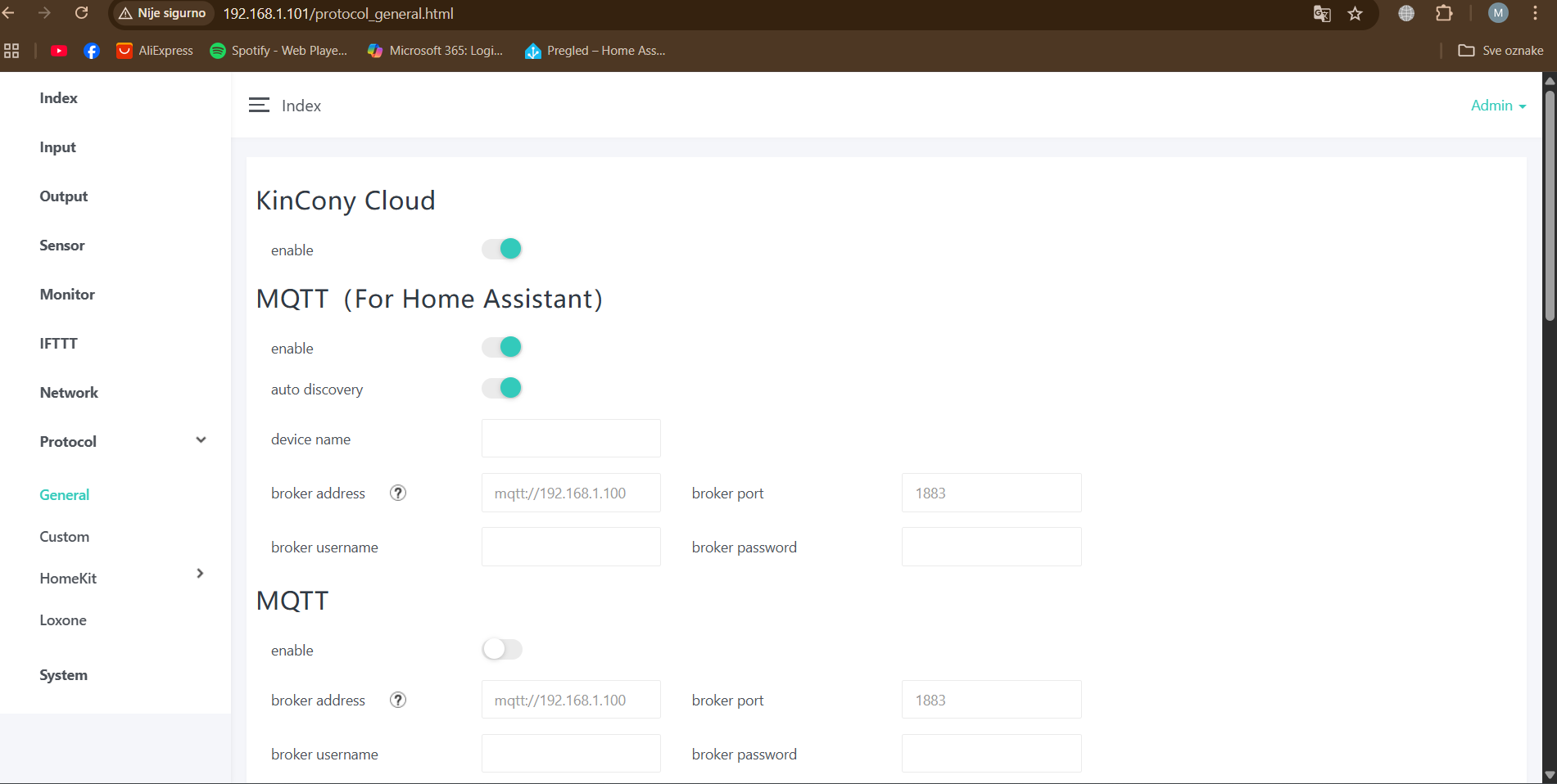

RE: b16m programing blinds - admin - 05-09-2025
install mosquito mqtt broker on your home assistant. then set the mosquito broker ip , port, user name, password in webpage.
[Image: protocol-general.png]
