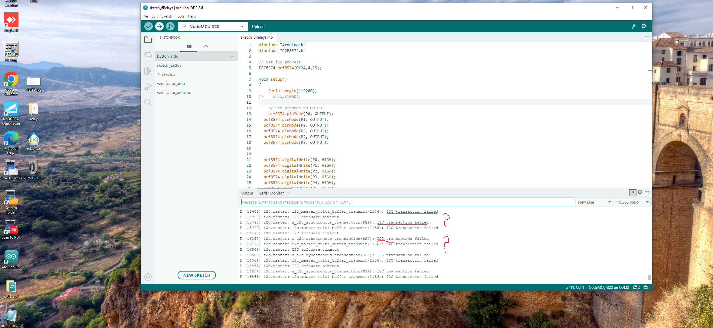

RE: Troubles using I2C/IIC bus - ksarz - 06-26-2025
Hi. There are of the my IDE code:
include <PCF8574.h>
#include <Wire.h>
#define SDA_PIN 4 // GPIO номер SDA
#define SCL_PIN 15 // GPIO номер SCL
void setup() {
Wire.begin(SDA_PIN, SCL_PIN); // Задали новые контакты для I²C
// Инициализируем I²C
Serial.begin(115200); // Инициализируем последовательный порт
while (!Serial); // Ждем открытия порта
Serial.println("\n\n--- I²C Scanner ---");
void loop() {
byte error, address;
int nDevicesFound = 0;
Serial.println("Scaning...");
for (address = 1; address < 127; address++ ) {
Wire.beginTransmission(address);
error = Wire.endTransmission();
if (error == 0) {
Serial.print("Device found at address: 0x");
if (address < 16) {
Serial.print("0");
Serial.println(address, HEX);
nDevicesFound++;
else if (error == 4) {
Serial.print("Unknown error at address: 0x");
if (address < 16) {
Serial.print("0");
if (nDevicesFound == 0) {
Serial.println("No I²C devices found.\n");
} else {
Serial.println("Scan complete.\n");
delay(5000); // Повторяем проверку каждые 5 секунд
Where it any mistake?

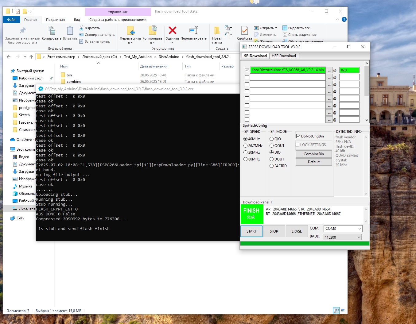

Dear Admin!
I have already installed the KSV firmware on my board several times.The version of the my  Firmware is  KC868_A6-v2.2.14.bin.
See  you the attachment.
After installation   this firmware I2C and relays does not wort on my Board too!

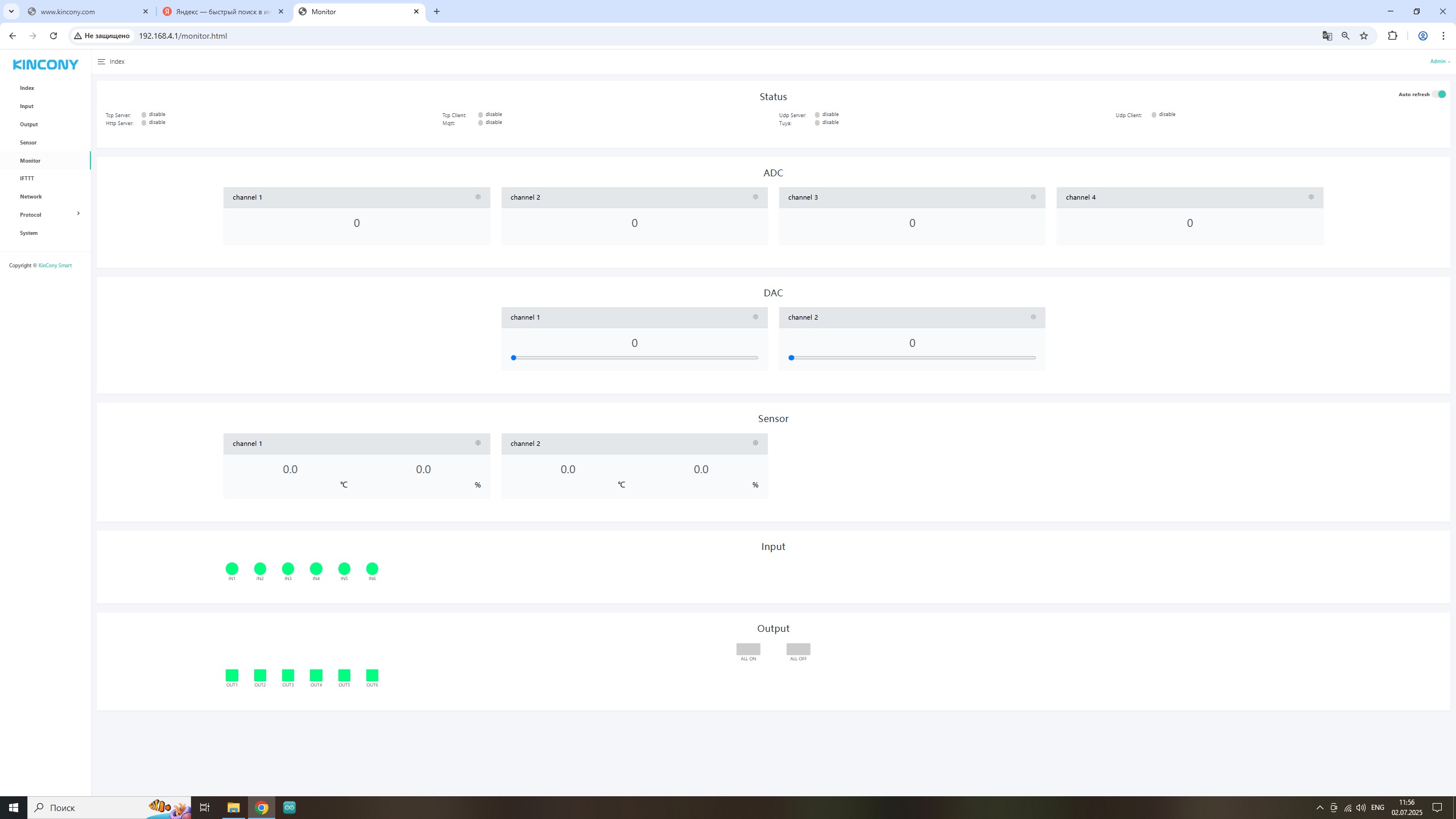

RE: Troubles using I2C/IIC bus - ksarz - 07-02-2025
Dear,Admin!
This is incredible!!
The KC 868 Board worked. But in the Monitor Menu there is NO RELAY,  Please see screenshot
