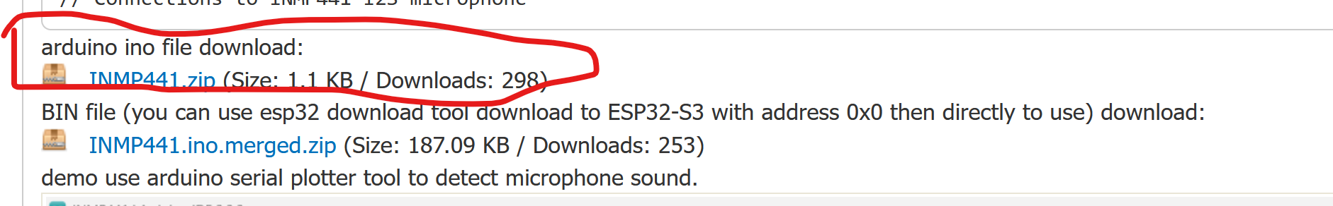

use this arduino code to test your microphone hardware whether is well.
https://www.kincony.com/forum/showthread.php?tid=6897

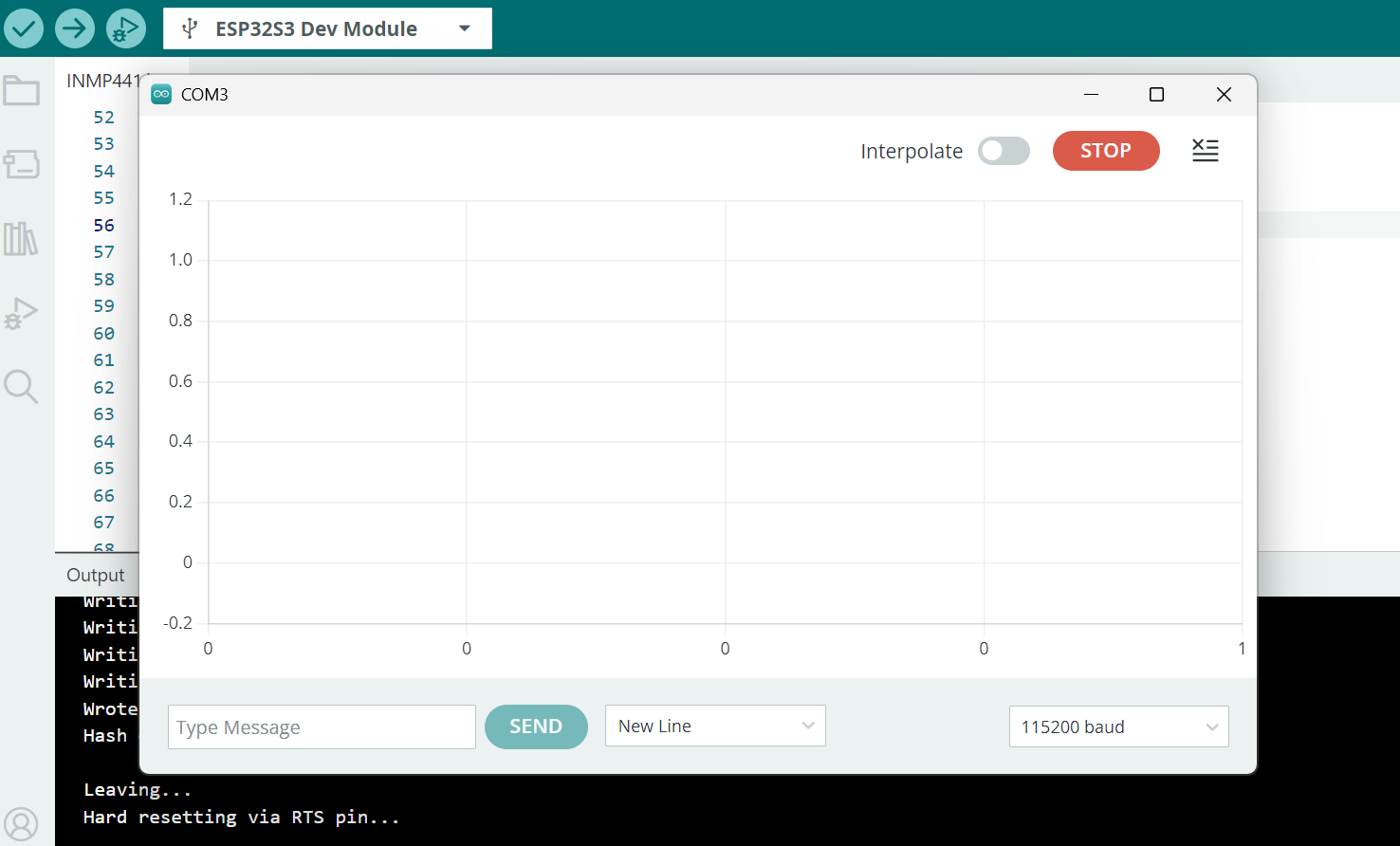

I successfully compiled and uploaded the Arduino code. When I attempted to flash the AS with the bin file after setting the parameters and clicking Start, no response was received; it simply idled. So, the process was not complete, and I could not carry out the mic test. What went wrong? See attached picture
RE: Kincony AS - admin - 09-07-2025
arduino code whether run well? when have sound, serial port output different numbers.
RE: Kincony AS - fdcemb5 - 09-07-2025
(09-07-2025, 04:51 AM)admin Wrote: arduino code whether run well? when have sound, serial port output different numbers.
Arduino code ran well, but no output on the Serial port, see photo

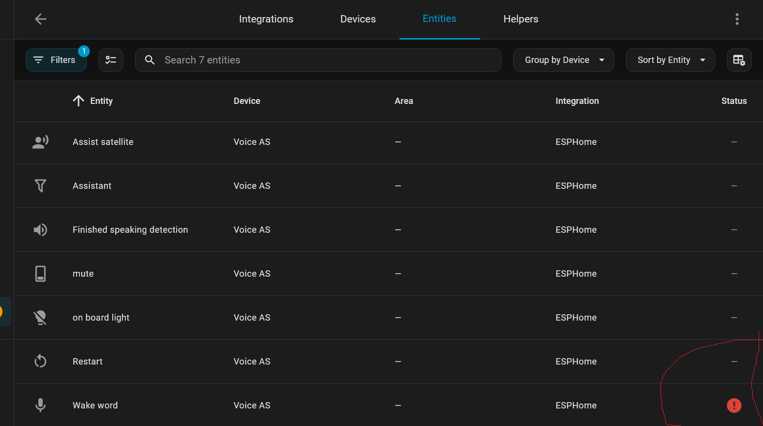

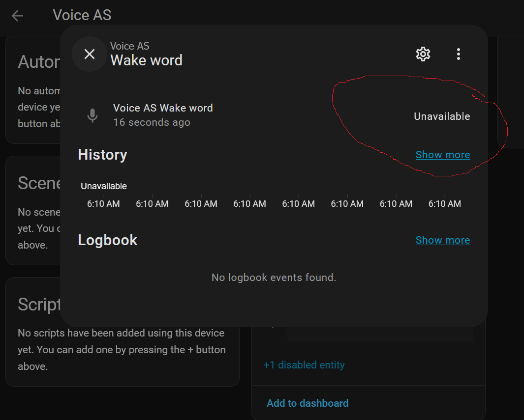

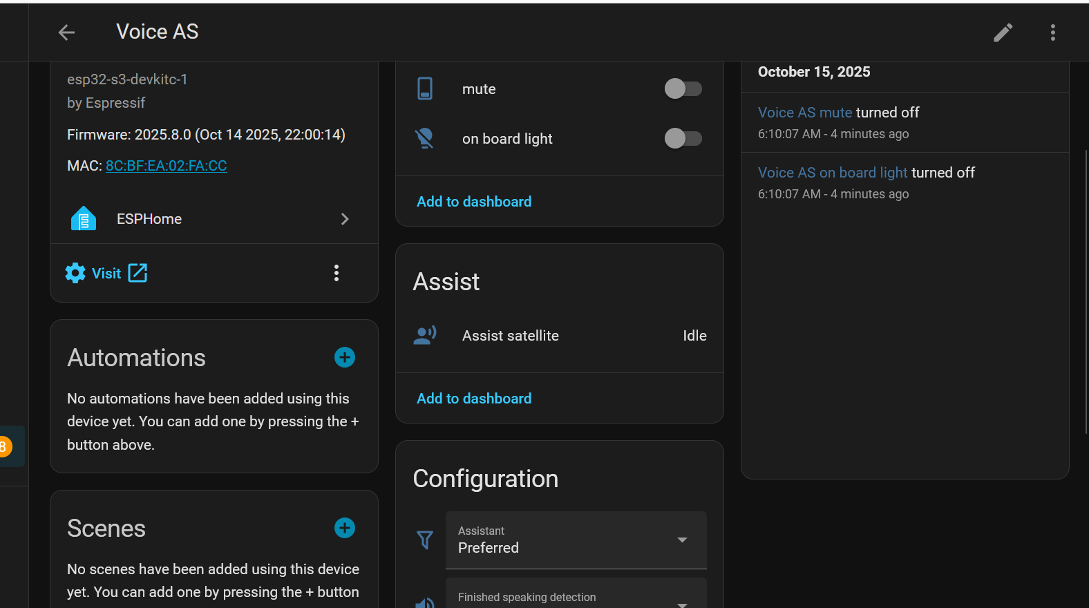

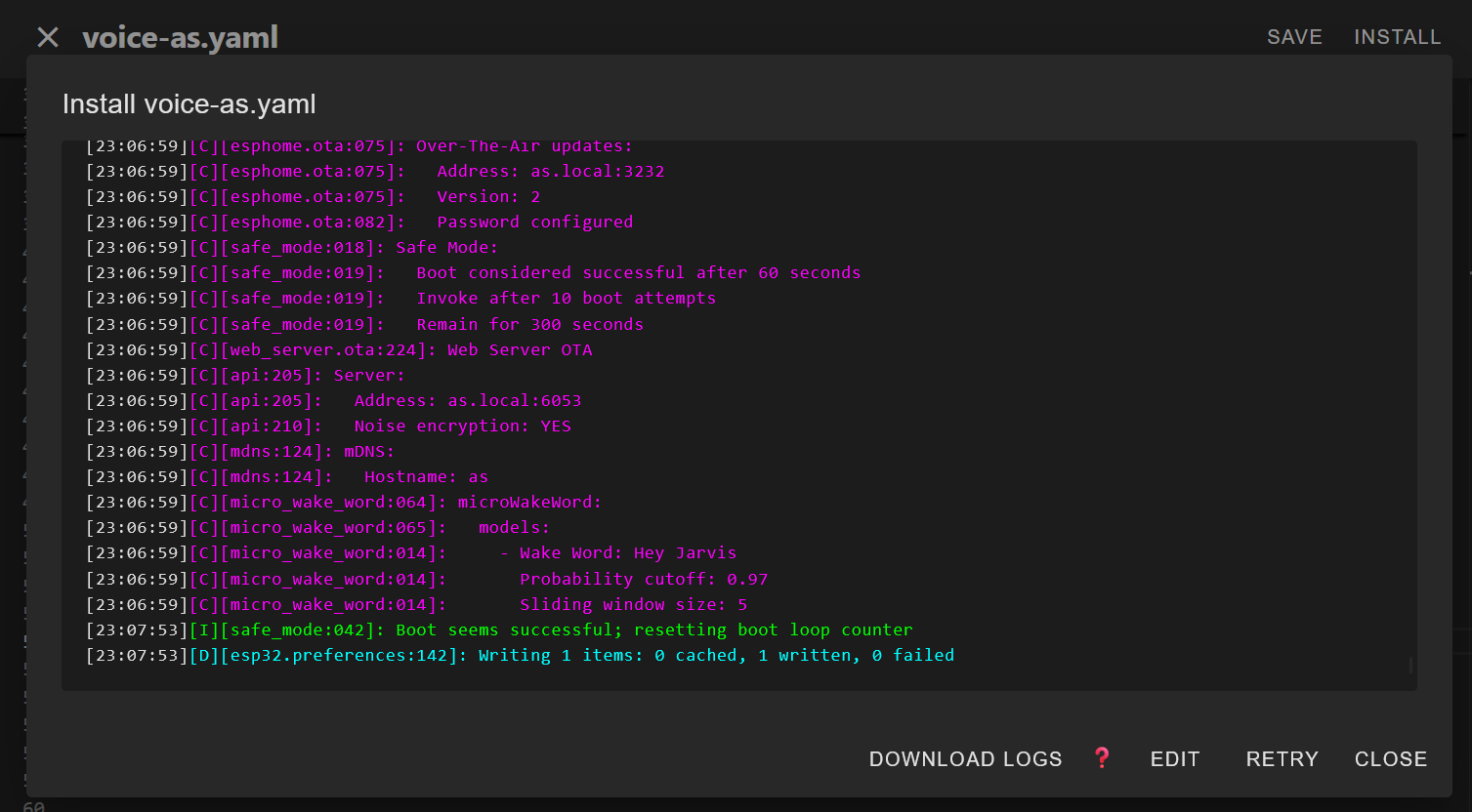

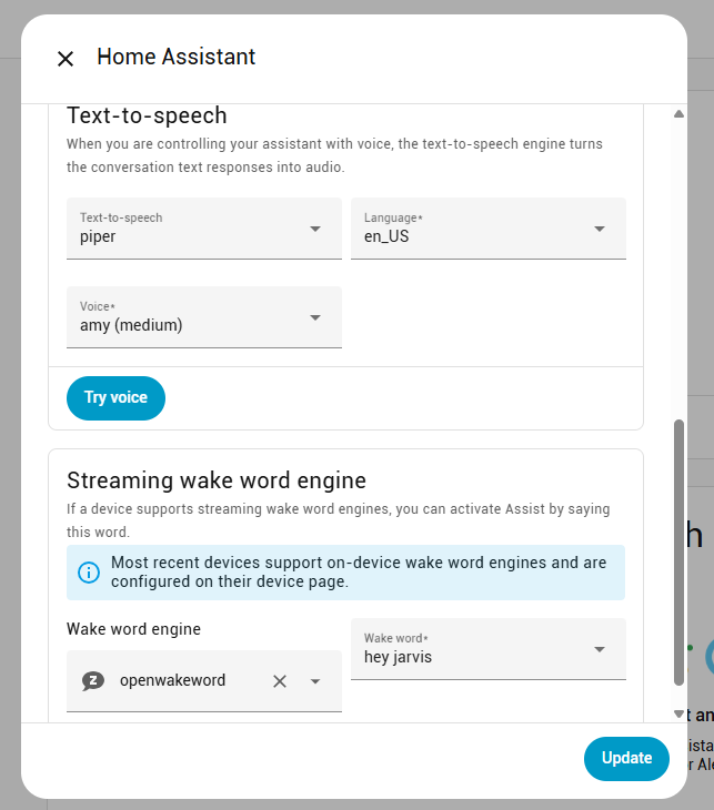

RE: Kincony AS - fdcemb5 - 10-15-2025
I started over to configure Kincony AS, but was unsuccessful. I have attached all the pictures of my configuration. The Wake Word appears unavailable. Kindly debug this issue as I have used three different HA installation with the same result. I bought four of these device. Kindly consider resolving this urgently.
RE: Kincony AS - admin - 10-15-2025
check your home assistant setting.
[Image: attachment.php?aid=8471]
[Image: attachment.php?aid=8470]
[Image: attachment.php?aid=8472]
[Image: attachment.php?aid=8473]
[Image: attachment.php?aid=8474]
newest yaml file download at here: https://www.kincony.com/forum/showthread.php?tid=6904&page=2
