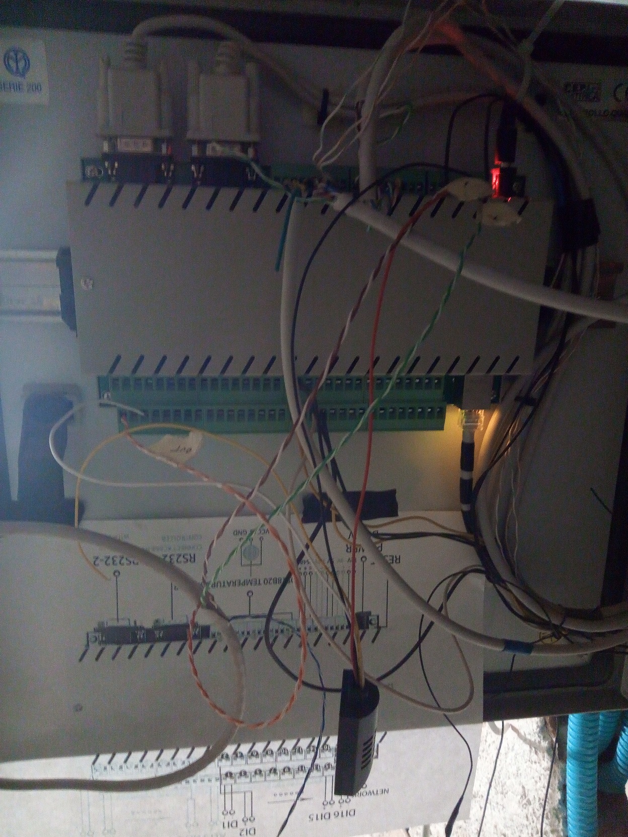

I still have problems with analog sensors. I bought DHTM-02S (analog sensor for temperature and humidity) and TMP36 (analog temperature sensor). I connected the power supplies on the + 5v and gnd pins of COL. the analog output of the sensor on A1 + of COL. with both sensors if I measure with the tester I have 0.6V on the analog channel. I tried to change the coefficient from COL but I can't set them correctly. is the analog output of the sensor on A1 + correct? can you help me? thank you RE: analog sensor 0-5V COL - admin - 04-25-2022 Do you using KC868-COL or KC868-COLB? you can take a photo of your device. RE: analog sensor 0-5V COL - athxp - 04-26-2022 use KC868-COL. attached photos. you can see the sensors connected to the 5v power supply and the input signals on AI1 and AI3. RE: analog sensor 0-5V COL - admin - 04-26-2022 "coefficient" is use for UI window to display, not for sensor setting. You should chose DC 0-5v analog output type sensor. |
