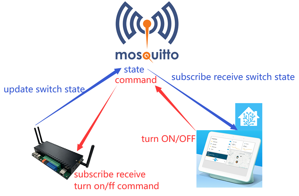

1.MQTT communication structure diagram
KC868-Server--------
publish message: status of switch (status topic)
Subscription message: turn on / off command (command topic)
home assistant------
publish message:  turn on / off command (command topic)
Subscription message: status of switch (status topic)
