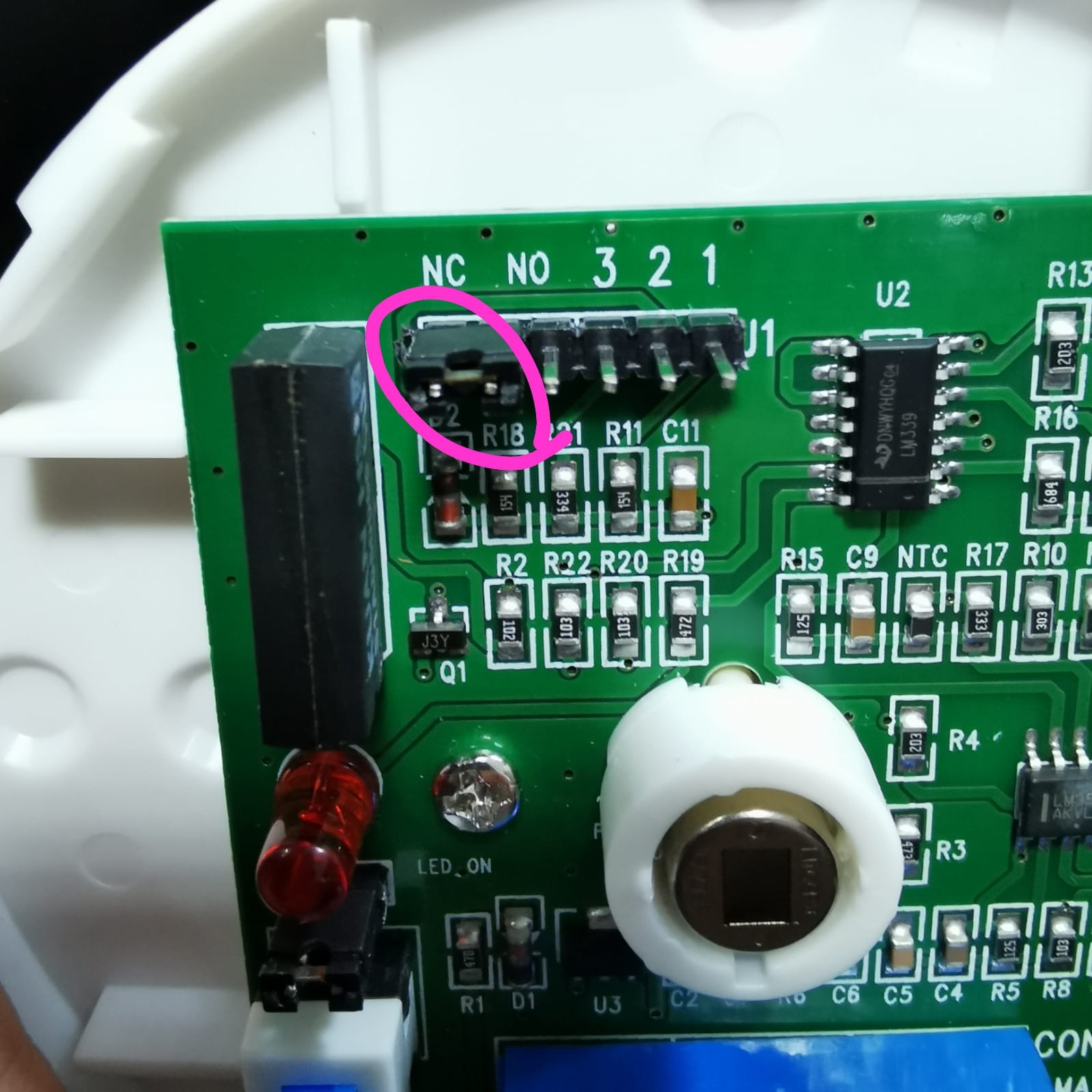

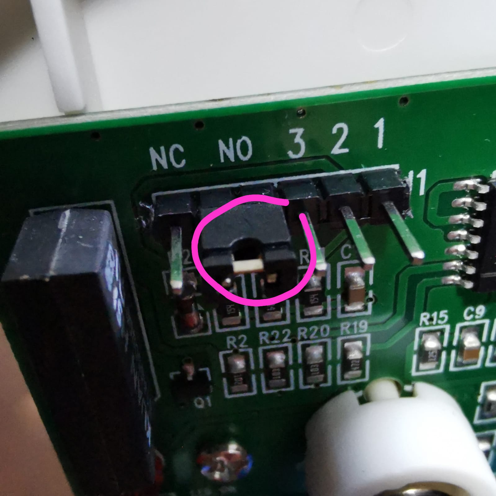

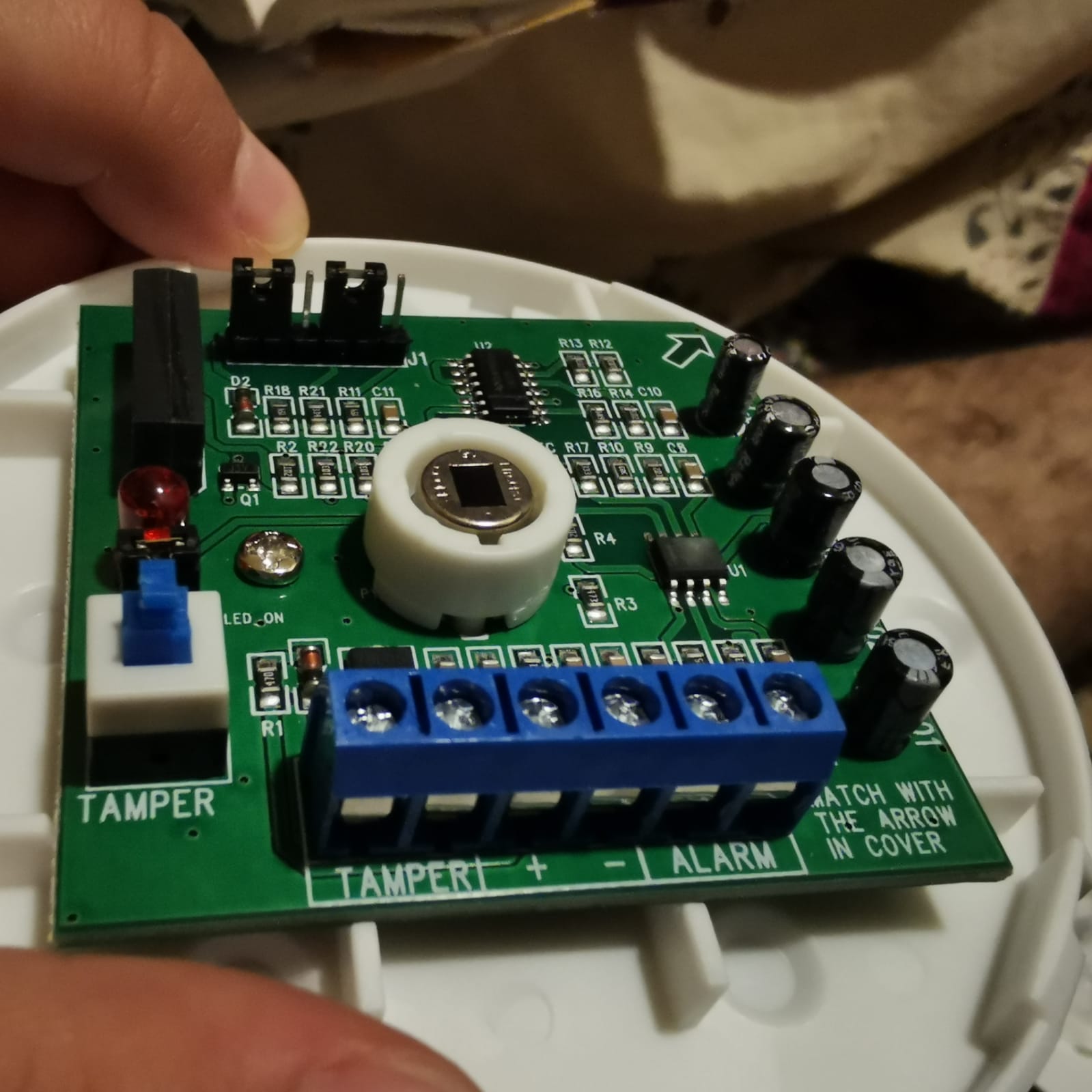

how to connect celling pir sensor with h32b pro - engmohades - 12-12-2022 how to connect celling pir sensor with h32b pro ? there are ( + - ) ( tamper ) ( alarm ) What is the tamper and How can I use the tamper in the home automation ? RE: how to connect celling pir sensor with h32b pro - admin - 12-13-2022 Red: +12v Black: GND Yellow: dry contact output. RE: how to connect celling pir sensor with h32b pro - engmohades - 12-14-2022 FOR USE celling PIR motion sensor with NO - and NC put jamper as same picture thanks for kinkony for help me RE: how to connect celling pir sensor with h32b pro - admin - 12-14-2022 you are welcome. |
