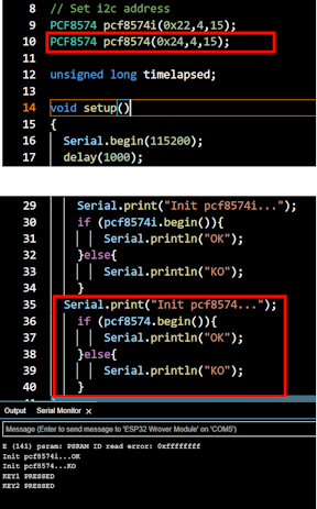

How to use two PCF8574s for DI and DO both?
Next program works correctly when I use only one PCF8574 (adress: 0x22; I2C pins: 4,15) that controls DI inputs on the board:
But it doesn't work when I uncomment code in red frames, trying to add another PCF8574 (adress: 0x24; I2C pins: 4,15) that controls DO outputs on the board.
Correct code for using digital input PCF8574 without errors   "1.png"

RE: Using two PCF8574s for DI and DO - admin - 06-25-2023
this is arduino source code for demo with KC868-A8 board, use INPUT and OUTPUT by PCF8574 at the same time. you can check.
