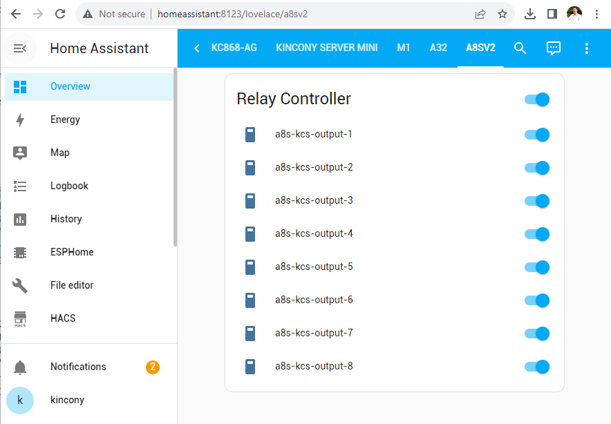

A8S config yaml for home assistant integration by KCS mqtt - admin - 09-19-2023
mqtt:
  - name: 'a8s-kcs-output-1'
    unique_id: a8s-kcs-output-1
    state_topic: 'KC868_A8S/08F9E08B1F58/STATE'
    command_topic: 'KC868_A8S/08F9E08B1F58/SET'
    state_on: true
    state_off: false
.txt   A8S_KCS_HA_mqtt.txt (Size: 3.13 KB / Downloads: 1,029)
just replace your own board's UID.
