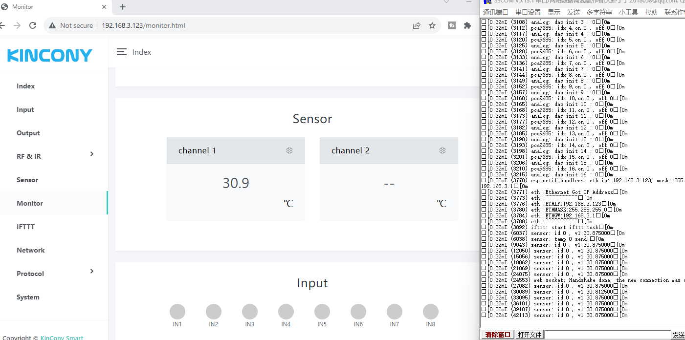

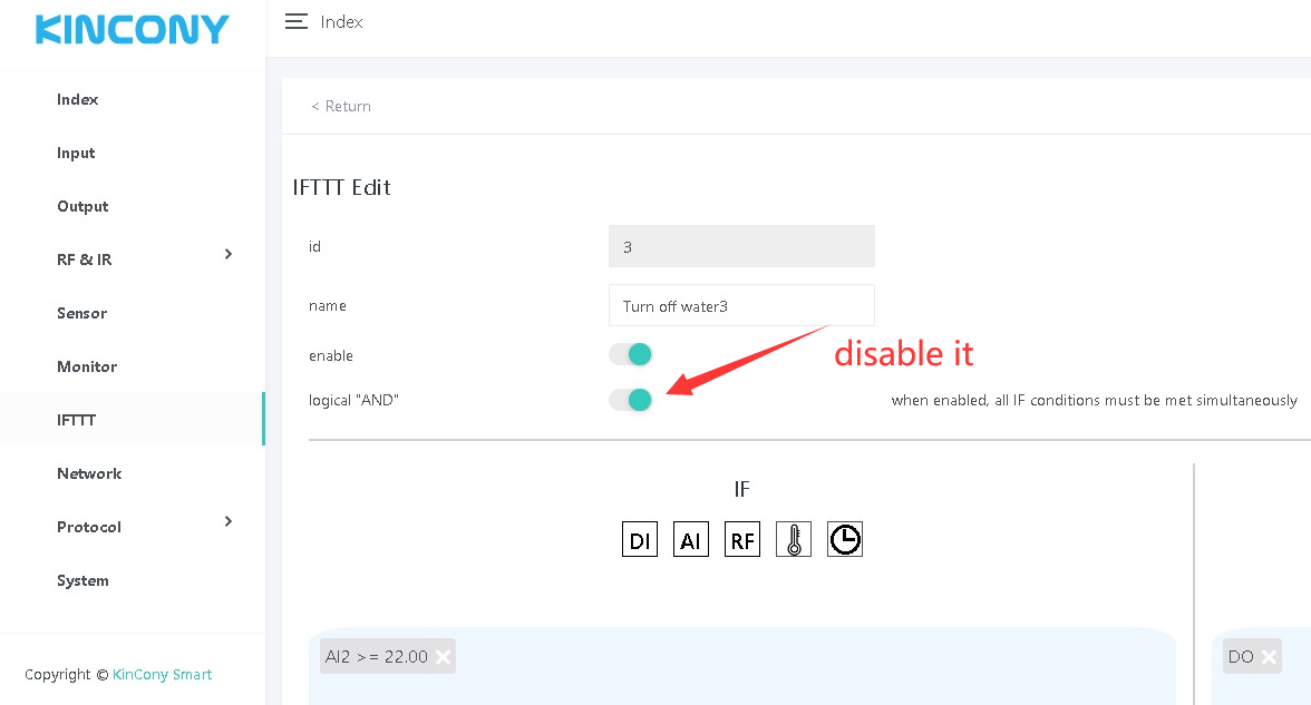

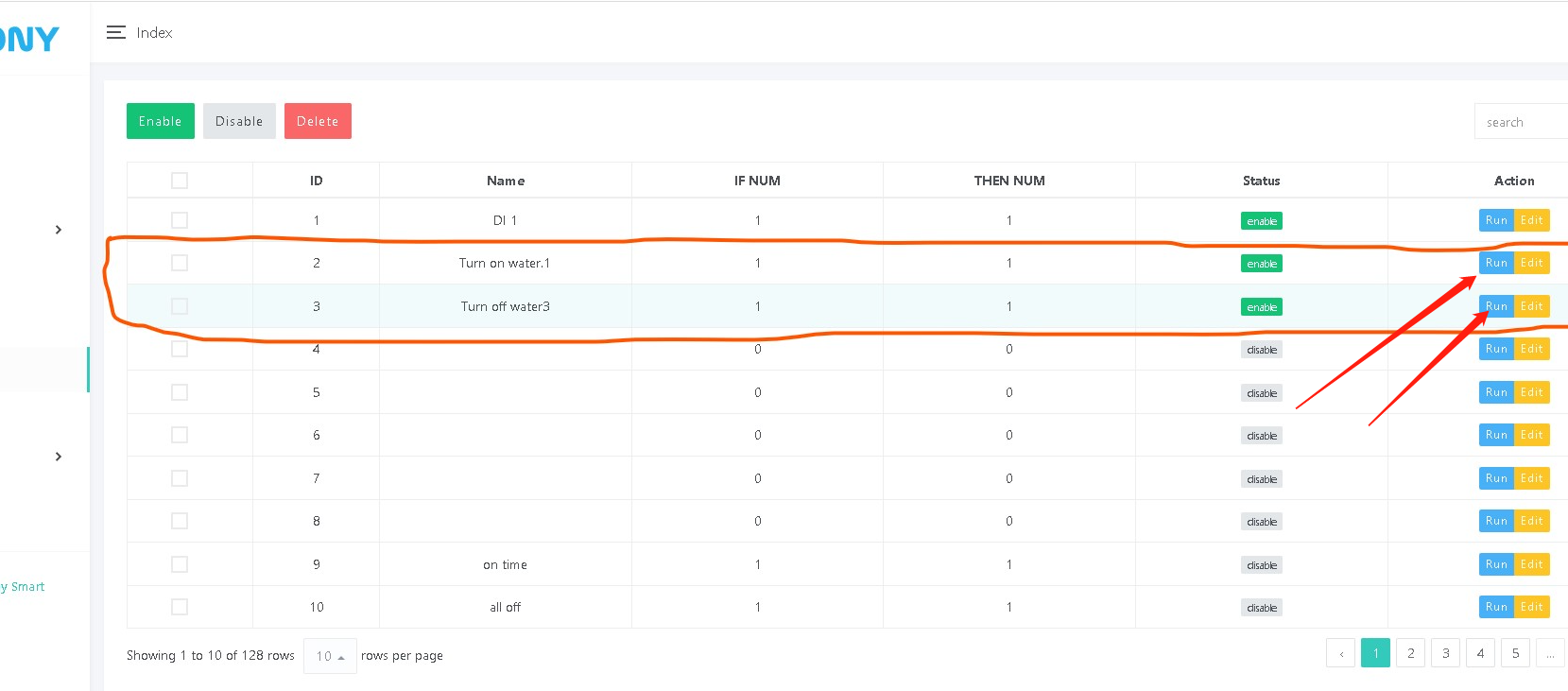

automation not working properly with KCS V2.1.2 - engmohades - 09-19-2023 Hello, how are you? I have a KC868-A8 device with firmware version kcsV2.1.2, and I'm experiencing issues with the automation not working properly. I have a water level sensor that is not responding to the automation commands, although it is able to read the water level accurately. RE: automation not working properly with KCS V2.1.2 - admin - 09-19-2023 make sure you have "enabled" IFTTT command. because i can't see your option in your photo. if already "enabled", then you can use this uart tool to monitor USB port, that can see LOG. when you trigger. take a screen photo of LOG.
UartAssist.zip (Size: 468.4 KB / Downloads: 509)
serial port baud is 115200bps. RE: automation not working properly with KCS V2.1.2 - engmohades - 09-19-2023 yes i enabledĀ IFTTT command , pls how to use uart tool ? RE: automation not working properly with KCS V2.1.2 - admin - 09-19-2023 PC connect to board by USB cable. open serial tool is ok. RE: automation not working properly with KCS V2.1.2 - engmohades - 09-19-2023 [0;32mI (125957854) ifttt: run ifttt rule :2 [0m [0;32mI (125963054) ifttt: run ifttt rule :2 [0m [0;32mI (126003774) sensor: temp 1 send![0m [0;32mI (126007789) sensor: temp 1 send![0m [0;32mI (126019824) sensor: temp 1 send![0m [0;32mI (126026844) sensor: temp 0 send![0m [0;32mI (126027855) sensor: temp 1 send![0m [0;32mI (126034875) sensor: temp 0 send![0m [0;32mI (126035885) sensor: temp 1 send![0m [0;32mI (126038895) sensor: temp 0 send![0m [0;32mI (126039906) sensor: temp 1 send![0m [0;32mI (126042915) sensor: temp 0 send![0m [0;32mI (126043925) sensor: temp 1 send![0m [0;32mI (126046935) sensor: temp 0 send![0m [0;32mI (126047946) sensor: temp 1 send![0m [0;32mI (126050958) sensor: temp 0 send![0m [0;32mI (126051130) web_server: close() fd (58) success.[0m [0;31mE (126051214) sensor: DS18B20 read error[0m [0;32mI (126054219) sensor: temp 0 send![0m [0;32mI (126055230) sensor: temp 1 send![0m [0;32mI (126059245) sensor: temp 1 send![0m [0;32mI (126062255) sensor: temp 0 send![0m [0;32mI (126063265) sensor: temp 1 send![0m [0;32mI (126066275) sensor: temp 0 send![0m [0;32mI (126067286) sensor: temp 1 send![0m [0;32mI (126070297) sensor: temp 0 send![0m [0;32mI (126071307) sensor: temp 1 send![0m [0;32mI (126074317) sensor: temp 0 send![0m [0;31mE (126074573) sensor: DS18B20 read error[0m [0;32mI (126077579) sensor: temp 0 send![0m [0;32mI (126078590) sensor: temp 1 send![0m [0;32mI (126081600) sensor: temp 0 send![0m [0;32mI (126085616) sensor: temp 0 send![0m [0;32mI (126086626) sensor: temp 1 send![0m [0;32mI (126089636) sensor: temp 0 send![0m [0;32mI (126090647) sensor: temp 1 send![0m [0;31mE (126092904) sensor: DS18B20 read error[0m [0;32mI (126093909) sensor: temp 1 send![0m [0;32mI (126096919) sensor: temp 0 send![0m [0;32mI (126097929) sensor: temp 1 send![0m [0;32mI (126100939) sensor: temp 0 send![0m [0;32mI (126101949) sensor: temp 1 send![0m [0;32mI (126104959) sensor: temp 0 send![0m [0;32mI (126108974) sensor: temp 0 send![0m [0;32mI (126109985) sensor: temp 1 send![0m [0;32mI (126117006) sensor: temp 0 send![0m [0;32mI (126118016) sensor: temp 1 send![0m [0;32mI (126122031) sensor: temp 1 send![0m [0;32mI (126125041) sensor: temp 0 send![0m [0;32mI (126126051) sensor: temp 1 send![0m [0;32mI (126129061) sensor: temp 0 send![0m [0;32mI (126130071) sensor: temp 1 send![0m [0;31mE (126132329) sensor: DS18B20 read error[0m [0;32mI (126136340) sensor: temp 0 send![0m [0;32mI (126137350) sensor: temp 1 send![0m [0;32mI (126144372) sensor: temp 0 send![0m [0;32mI (126145383) sensor: temp 1 send![0m [0;32mI (126152404) sensor: temp 0 send![0m [0;32mI (126153414) sensor: temp 1 send![0m [0;32mI (126161440) sensor: temp 1 send![0m [0;32mI (126164450) sensor: temp 0 send![0m [0;32mI (126169470) sensor: temp 1 send![0m [0;32mI (126172480) sensor: temp 0 send![0m [0;32mI (126177501) sensor: temp 1 send![0m [0;32mI (126184522) sensor: temp 0 send![0m [0;32mI (126185532) sensor: temp 1 send![0m [0;32mI (126192553) sensor: temp 0 send![0m [0;32mI (126193563) sensor: temp 1 send![0m [0;32mI (126201591) sensor: temp 1 send![0m [0;32mI (126204601) sensor: temp 0 send![0m [0;32mI (126209621) sensor: temp 1 send![0m [0;32mI (126221657) sensor: temp 1 send![0m [0;32mI (126224101) web_server: close() fd (53) success.[0m [0;32mI (126224103) web_server: close() fd (54) success.[0m [0;32mI (126224104) web_server: close() fd (55) success.[0m [0;32mI (126224110) web_server: close() fd (56) success.[0m [0;32mI (126224114) web_server: close() fd (57) success.[0m [0;32mI (126224668) sensor: temp 0 send![0m [0;32mI (126233698) sensor: temp 1 send![0m [0;32mI (126240720) sensor: temp 0 send![0m [0;33mW (126244875) httpd_ws: httpd_ws_get_frame_type: Failed to read header byte (socket FD invalid), closing socket now[0m [0;32mI (126244879) web_server: close() fd (59) success.[0m [0;32mI (126245740) sensor: temp 1 send![0m [0;32mI (126256770) sensor: temp 0 send![0m [0;31mE (126257026) sensor: DS18B20 read error[0m [0;32mI (126261036) sensor: temp 1 send![0m [0;32mI (126272066) sensor: temp 0 send![0m RE: automation not working properly with KCS V2.1.2 - engmohades - 09-19-2023 It only responds to the automation for turn on KC868-A8 relays at a certain value, but it does not respond to the automation to turn off the A8 relays when the tank is filled. RE: automation not working properly with KCS V2.1.2 - admin - 09-19-2023 take a photo of your IFTTT command. you need to create two IFTTT command, both been enabled. RE: automation not working properly with KCS V2.1.2 - engmohades - 09-20-2023 (09-19-2023, 10:17 PM)admin Wrote: take a photo of your IFTTT command. RE: automation not working properly with KCS V2.1.2 - admin - 09-20-2023 you should disable option "and" RE: automation not working properly with KCS V2.1.2 - KinCony Support - 09-20-2023 (09-20-2023, 04:52 AM)engmohades Wrote:(09-19-2023, 10:17 PM)admin Wrote: take a photo of your IFTTT command. Click run to test the settingsĀ |
