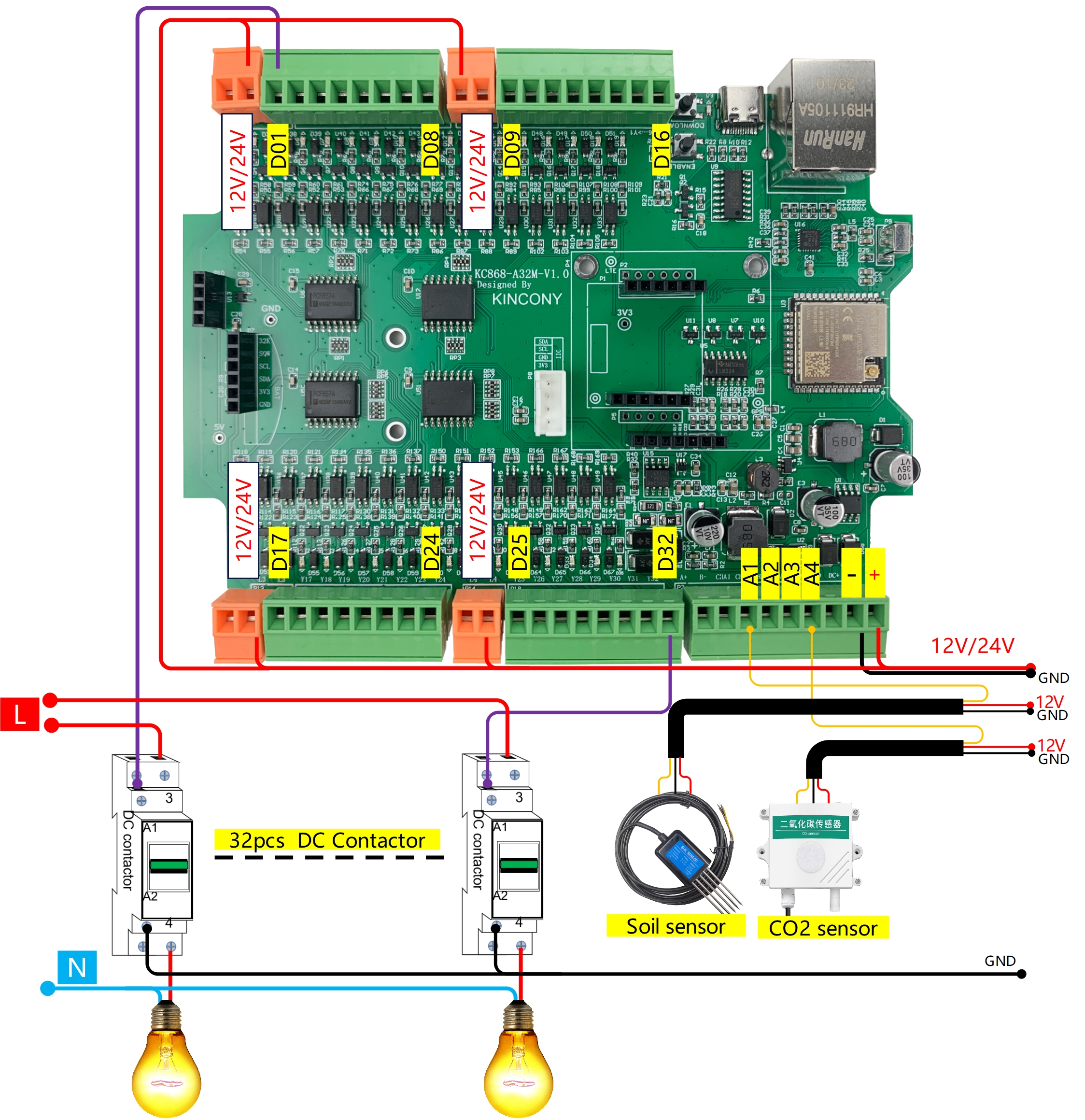

KC868-A32M wiring diagram - KinCony Support - 10-13-2023 RE: KC868-A32M wiring diagram - charlesrg - 01-01-2024 Why is this showing Negative side switching ? And not positive switching similar to A16 Diagram ? RE: KC868-A32M wiring diagram - admin - 01-29-2024 sorry, maybe we should need the RED color, actually the OUTPUT is positive. RE: KC868-A32M wiring diagram - KinCony Support - 01-29-2024 |
