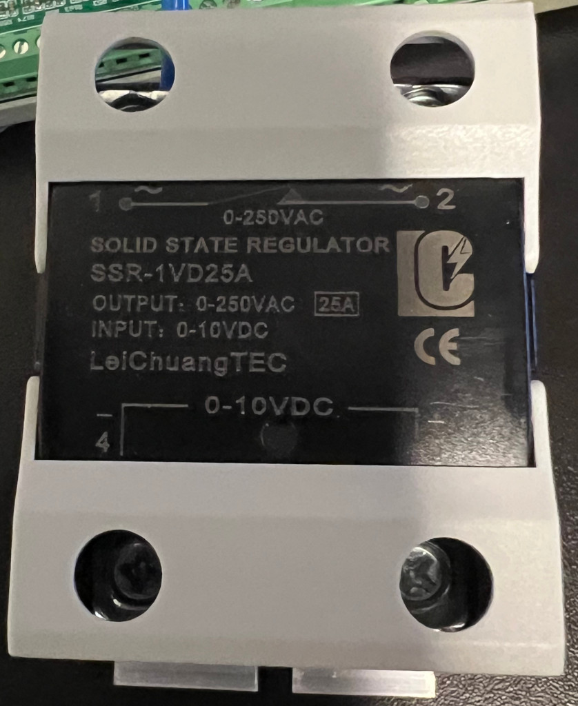

KC868-D16 + Relay SSR (Voltage Regulator) - ale_ - 12-04-2023 Hello, Thank you for the great boards that you build, the looks very quality and the features are amazing ! I'm testing the future setup of my home, I bought KC868-D16 for light dimmer and some Relay SSR Voltage Regulators. I know that you always recommend the following relay (https://www.aliexpress.us/item/3256801518590551.html) to use with your board, but I it's much more expensive than alternatives I've found. I have searched for the same spec: - 0-10VDC Control Input - 0-250VAC Output There's any additional spec that I should pay attention when looking for alternative ? Because the relays that I've bought are not working, when I change the dimmer bar their led don't even power up.... The pictures of relays are attached. I found the full spec of the ssr relays voltage regulator I have RE: KC868-D16 + Relay SSR (Voltage Regulator) - admin - 12-04-2023 when you use app change lamp brightness = 100%, lamp can't ON? RE: KC868-D16 + Relay SSR (Voltage Regulator) - ale_ - 12-05-2023 (12-04-2023, 10:39 PM)admin Wrote: when you use app change lamp brightness = 100%, lamp can't ON? No, lamp doesn’t turn on. RE: KC868-D16 + Relay SSR (Voltage Regulator) - admin - 12-05-2023 draw a diagram, how you connect with wire. RE: KC868-D16 + Relay SSR (Voltage Regulator) - ale_ - 12-07-2023 The issue was that the load was < 50W. I was trying with a led bulb of 10W, change to one of 60W works. The doubt that remains is what to do if I need to dimmer a circuit of 4 led bulbs of 10W each ? RE: KC868-D16 + Relay SSR (Voltage Regulator) - admin - 12-07-2023 our SSR need >18W load. maybe your SSR is different. RE: KC868-D16 + Relay SSR (Voltage Regulator) - ale_ - 02-05-2024 (12-07-2023, 02:29 PM)admin Wrote: our SSR need >18W load. maybe your SSR is different. I have additional questions: When you say "our SSR" is that one ? https://pt.aliexpress.com/item/1005001704905303.html?pdp_npi=4%40dis%21BRL%21R%24%2083%2C51%21R%24%2083%2C51%21%21%2116.00%2116.00%21%402101f04d17071334759618872ef4cf%2112000017226746067%21sh%21BR%21899118599%21&spm=a2g0o.store_pc_allItems_or_groupList.new_all_items_2007507417297.1005001704905303&gatewayAdapt=glo2bra Even when using your SSR, what can I do if I need to dimmer < 18W ? What information should I pay attention on the SSR specs to know the load need to work ? RE: KC868-D16 + Relay SSR (Voltage Regulator) - admin - 02-05-2024 yes, that link we have tested, other brand we have not used, it's not easy to say whether work well. RE: KC868-D16 + Relay SSR (Voltage Regulator) - ale_ - 02-05-2024 (02-05-2024, 12:22 PM)admin Wrote: yes, that link we have tested, other brand we have not used, it's not easy to say whether work well. Ok. But how to make a < 18w load work your ssr ? RE: KC868-D16 + Relay SSR (Voltage Regulator) - admin - 02-06-2024 if you use "tungsten wire type" light bulb, not MUST >18W. you can add whatsapp number: +86-15381188302 i can send you a video D16 work with SSR and bulb. also we are designing new dimmer board, here is video tour: https://youtube.com/shorts/LANReKNJuM8 |
