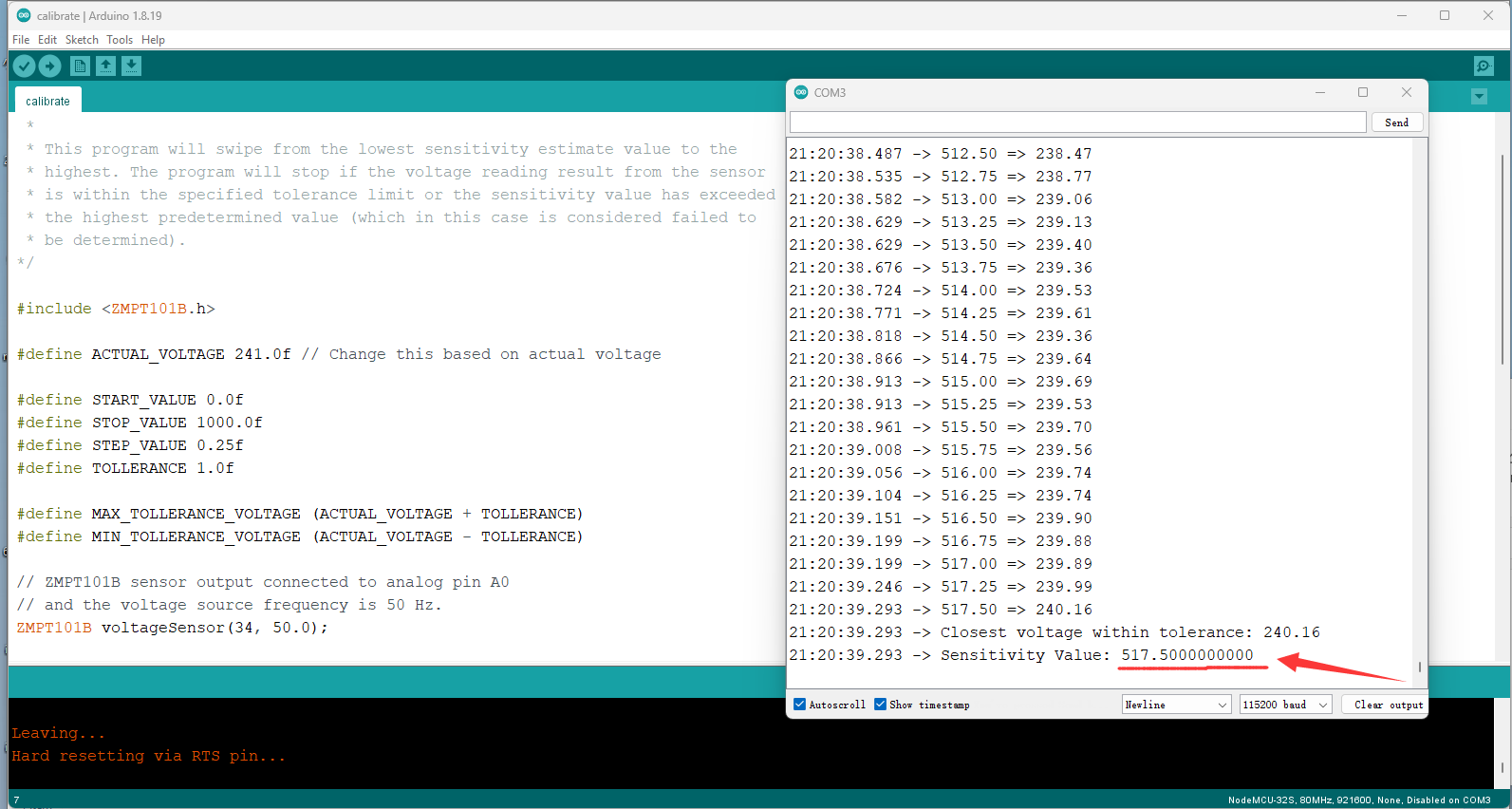

how to calibrate AC voltage for M16V2 - admin - 12-09-2023 1. run arduino calibration program code to find your "Sensitivity" value for ESPHome M16v2 component. here is arduino code: https://www.kincony.com/forum/showthread.php?tid=3089 before use this arduino code, you need install "ZMPT101B" arduino library firstly. then before run this code, use multi meter test your L and N voltage , then only "Change this based on actual voltage" in code: when running this code, serial port will print "Sensitivity" value at the end. then change "Sensitivity" value in home assistant "/homeassistant/esphome/zmpt101b/zmpt101b_custom_sensor.h" now it's completed. |
