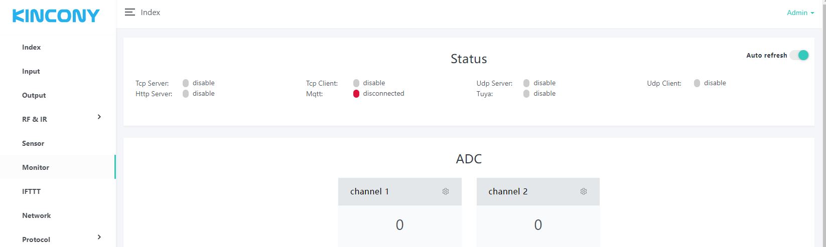

Hi,
I attached two pictures, one with the settings and one with the current status
The port 2883 is the correct port number of my broker
Yamaray
RE: KC868-A8 mqtt connection - admin - 01-07-2024
"broker address" you should input "mqtt://192.168.0.98"
But you have input "192.168.0.98", it's different.

Hi,
Thank you for clarifying the point.
Now it is working fine.
