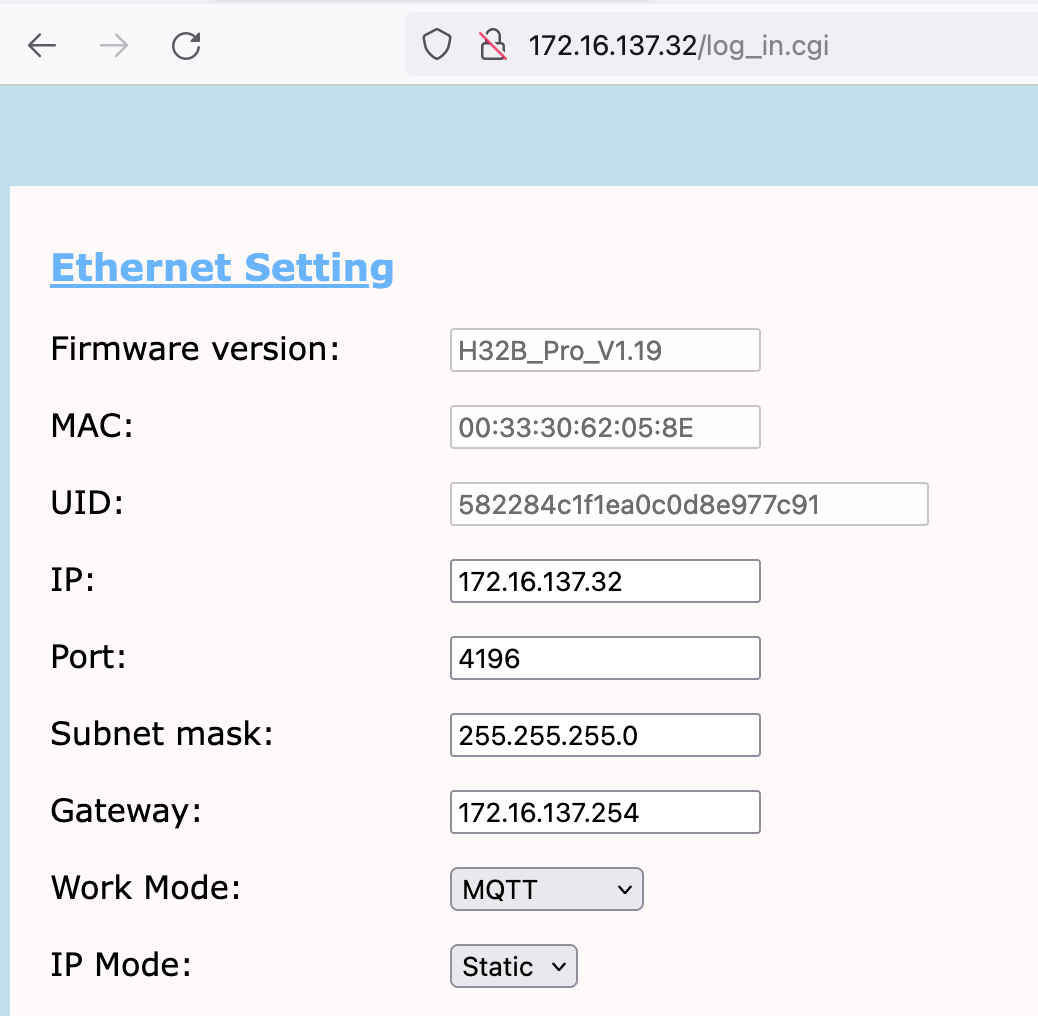

When I access the web terminal of the H32B-Pro via its local IP, the default values for "Firmware Version", "MAC" and "UID" are greyed out. This is neither the case in the Youtube video nor the documentation.
Anyway, I enter all the information:
IP:  192.168.1.200 (static local IP of H32B-Pro controller shown in the router)
Port: 4196
Subnet mask: 255.255.255.0 (same as router config)
Gateway: 192.168.1.1 (router IP)
Work Mode: MQTT
IP MODE: DHCP
Domain Name : left empty (not shown in documentation?!? Newer version??)
Server IP:  192.168.1.27 (static local IP of RaspberryPi, running Home Assistant with Mosquitto MQTT Server AddIn installed)
Server Port: 1883 (double-checked in Mosquitto config)
MQTT username: same as shown in Mosquitto config
MQTT password: same as shown in Mosquitto config
The WIFI settings I leave blank.

RE: H32B Pro via Ethernet - no default values in web interface - lulu01 - 04-09-2024
Hello, I have a similar issue. I have 2 H32B Pro, using firmware 1.19. I can reproduce this issue every time:
I hold the Ethernet button until I have yellow+blue+red, and I release it. The board uses 192.168.1.200.
I login on the web interface at 192.168.1.200.
I change the IP. I can reboot the card multiple times, everything works OK.
I login on the web interface, set the mode to MQTT and restart the board.
Next time I login, all the fields are empty.
This happens on both boards.
The only way I have to fix this is to reset the board - hold Ethernet button until I have yellow+blue+red, and then I need to start over.
Please help...
Some extra info: when I try to access the web interface and all the fields are blank, MQTT also stops working and commands sent from Home Assistant are not executed. After one or two minutes, there is a sort of timeout, and all the commands sent that were not executed are executed at once.
