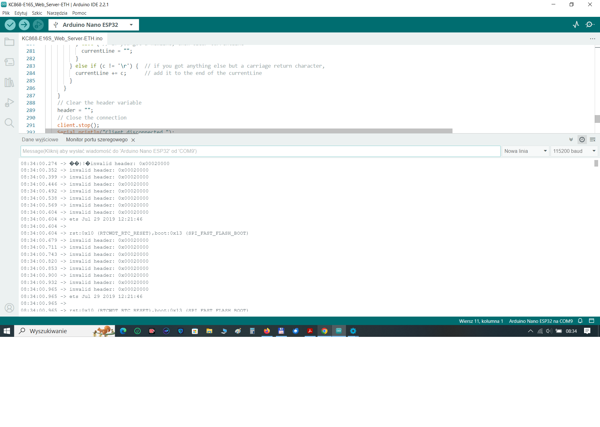

ProblemKC868 - SP9HYX - 01-24-2024 Welcome, I have a problem with loading bin-a 21.9, I have loaded as at this screenshot When i turn on monitor i have this information I ask you for help at what i did wrong, i want to turn on this and use it. Best Regard Jacek RE: ProblemKC868 - admin - 01-24-2024 here is newest KCS firmware download link: https://www.kincony.com/forum/showthread.php?tid=3791 just when you download by ESP download tool, set address with 0x0, now in your photo, address is wrong. |
