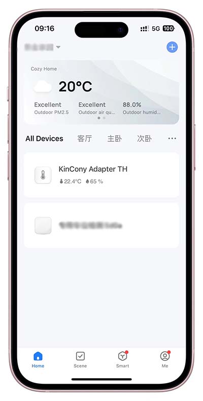

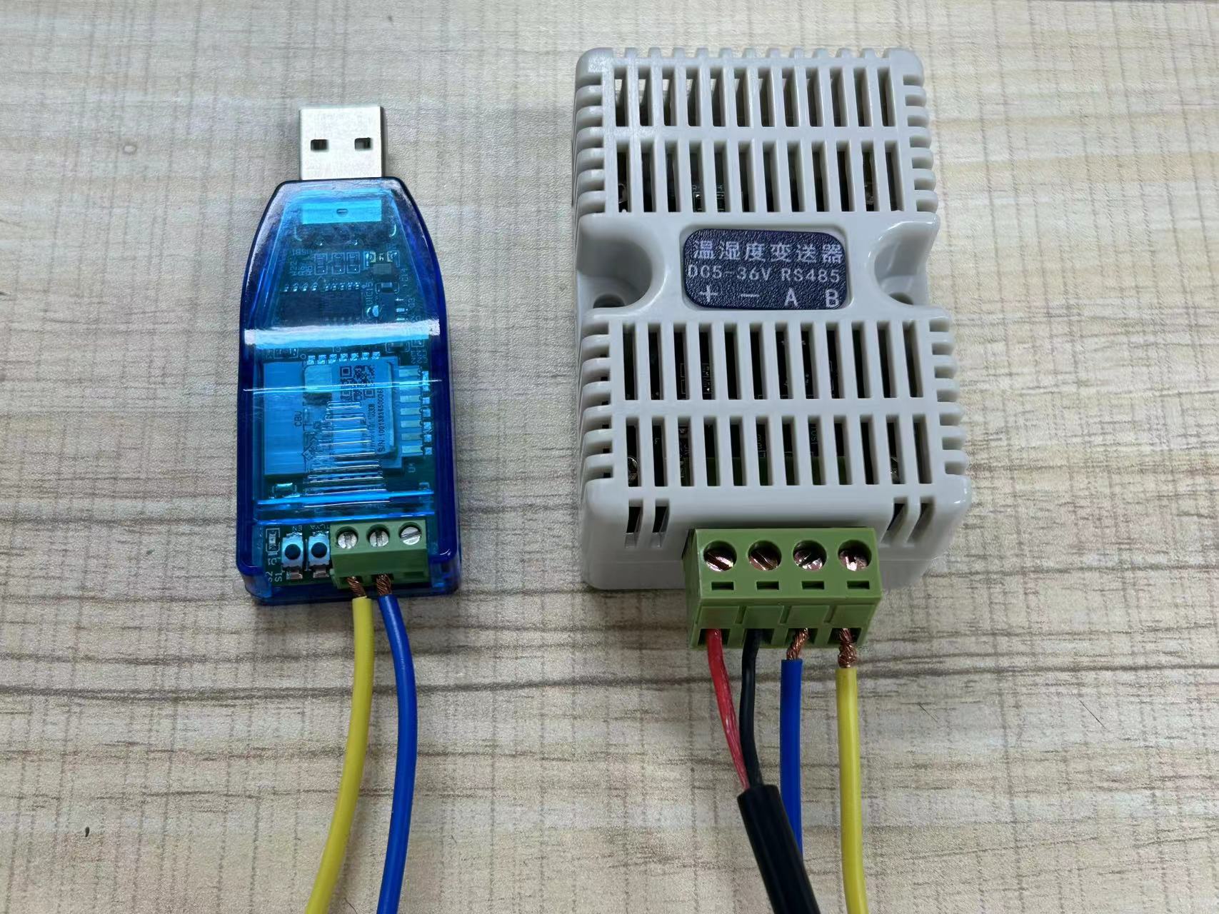

let your own RS485 temperature and humidity sensor can work with Tuya app, so that can remote monitor sensor data and make AUTOMATION by Tuya app via internet.
