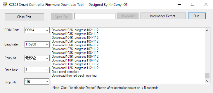

download the ZIP file , unzip update the bin file for KC868-H32B relay controller by USB-RS232 cable.
.zip   Relay32_V437_210907.zip (Size: 46.05 KB / Downloads: 1,344)
firmware update tool download: https://www.kincony.com/download/KC868-Controller-Bootloader.zip

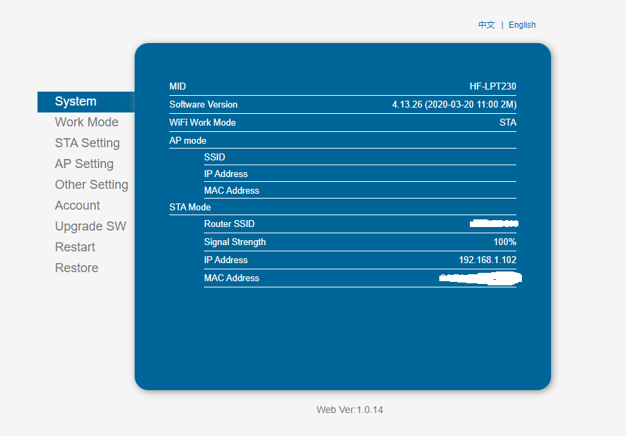

RE: KC868-H32B V4.37 new firmware update - mfauziii - 10-03-2021
I have done firmware updates, but seem nothing has changed. I have follow firmware updates guide from, https://www.youtube.com/watch?v=LLIJe9VTVq8
After firmware updates:
0 Software Version: 4.13.26 (2020-03-20 11:00 2M)
