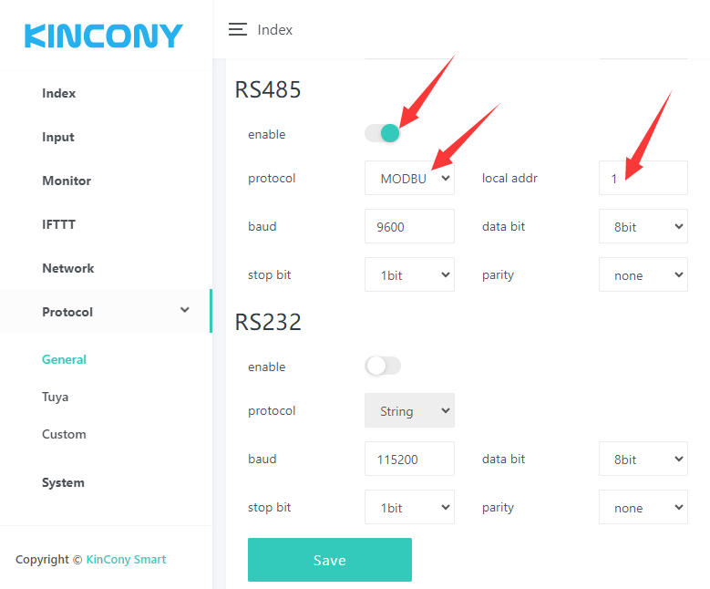

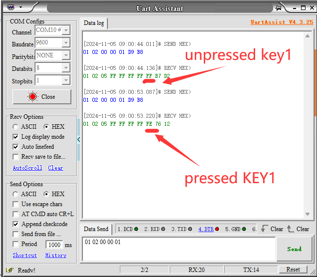

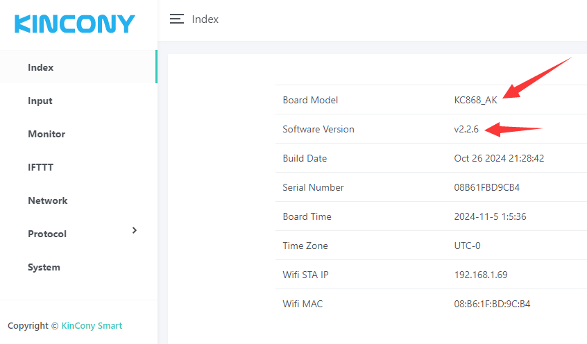

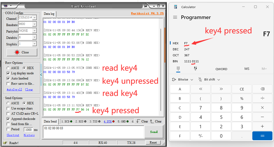

RS485 usage - charlesjabged - 11-02-2024 I just received the keyboard and i am trying to read button state with modbus. I try to use this: https://www.kincony.com/forum/attachment.php?aid=2240 but it is really unclear to me. I try coils, inputs reg, and holding with: 1 stop bit, no parity, 9600 baud. I have 3 others devices that work well on the same modbus line ( with different MB address ). Can you help me with the correct way to poll button status ? (i will do a request every 1sec). thank you in advance. RE: RS485 usage - admin - 11-02-2024 ok, next week when we begin work, i will test it ,feedback to you at here. RE: RS485 usage - charlesjabged - 11-03-2024 I just updated this firmware using your tools. How can i check the version to know if the update is correct ? RE: RS485 usage - admin - 11-03-2024 download this firmware file: https://www.kincony.com/forum/attachment.php?aid=6311 after download, unzip, just download BIN file to ESP32. RE: RS485 usage - charlesjabged - 11-03-2024 (11-03-2024, 10:58 AM)admin Wrote: download this firmware file: https://www.kincony.com/forum/attachment.php?aid=6311 That exactly what i did. Then, i can connect to the wifi AP and go to the web interface. The software version is: 1.0.6. but the file linked is 2.2.6. Is there a why to check if the new firmeware was really written on the targeted device ? RE: RS485 usage - charlesjabged - 11-03-2024 (11-03-2024, 11:14 AM)charlesjabged Wrote:(11-03-2024, 10:58 AM)admin Wrote: download this firmware file: https://www.kincony.com/forum/attachment.php?aid=6311 Just to let yo know that, after multiple try, i was able to update the board successfully. Now, i am able to read 35 coils. The only problem is that the coils 1 do not correspond to input 1. [1]: 1 [2]: 1 [3]: 1 [4]: 0 [5]: 0 [6]: 0 [7]: 0 [8]: 0 [9]: 1 [10]: 1 [11]: 1 [12]: 1 [13]: 1 [14]: 1 [15]: 1 [16]: 1 [17]: 1 [18]: 1 [19]: 1 [20]: 1 [21]: 1 [22]: 1 [23]: 1 [24]: 1 [25]: 1 [26]: 1 [27]: 1 [28]: 1 [29]: 1 [30]: 1 [31]: 1 [32]: 1 [33]: 1 [34]: 1 [35]: 1 From 4 to 8, inputs seems to be reversed. is it normal ? RE: RS485 usage - admin - 11-04-2024 do you want send single command to read everyone register? or use one command to read all INPUT register? RE: RS485 usage - admin - 11-05-2024 tested with KCS firmware, enabled rs485 modbus as follows, INPUT1 (key1) is no problem. see the photos. INPUT 1-35 begin with RS485 register 0 tested with key4 ,also is well. bit "0" means "pressed". |
