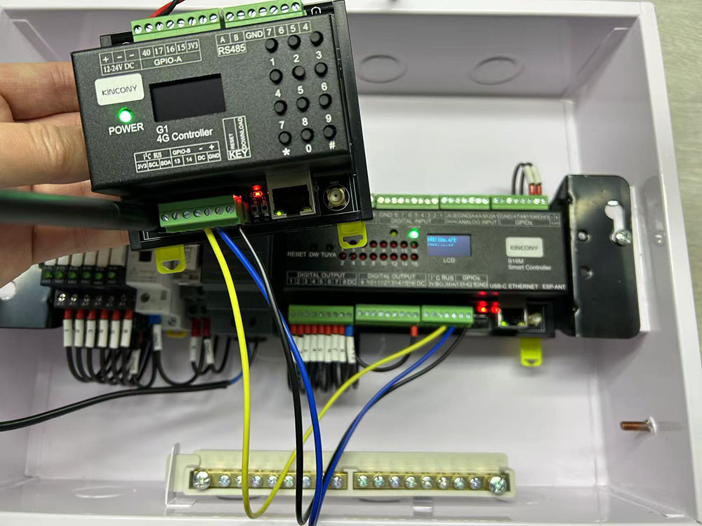

SIM7600E AT command transparently transmitted to ESP32 Arduino code and BIN firmware - admin - 12-06-2024
function: Use KinCony G1 module to transparently transmit AT commands of SIM7600 4G module to gpio13 and gpio14 of esp23-s3. So that KinCony Controller can connect with extend G1 4G module by KCS v3 firmware.
