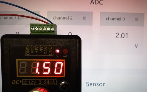

analog input resolution 30%erro - jltluc57 - 01-19-2025 Hello Can you tell me the resolution on the analog inputs. Because for 1.5v in I visualize 2.01v which is 30% error.. That's a lot Board A16 RE: analog input resolution 30%erro - admin - 01-19-2025 you can check with this video , how to config analog by esphome: https://www.kincony.com/forum/showthread.php?tid=3499 RE: analog input resolution 30%erro - jltluc57 - 01-25-2025 I watched the video, but I don't use Home Assistant. And that doesn't solve the problem. In any case if I put 1.5 volts on the analog input, in the Monitor part of the KC868_A16 card, I should see 1.5V and not 2.01Volts. ADC is in the A16 card in any case the displayed value must be correct. Whatever the system that will read the value, it must be correct at the source therefore KC868_A16. You don't agree? RE: analog input resolution 30%erro - admin - 01-26-2025 click the right ico "gear" , take a photo, what you have set. RE: analog input resolution 30%erro - jltluc57 - 01-26-2025 Hi, Here RE: analog input resolution 30%erro - admin - 01-26-2025 the battery “-” have connected with board's power supply's GND? do you want to monitor a battery voltage? RE: analog input resolution 30%erro - jltluc57 - 01-27-2025 Yes the gnd is connected Look at the photos of the posts I test the capacities, reliability, etc of the card before buying others. There I am on the analog inputs and I look at the reliability of the measurement, I send 1.5v I see that I have 2.01 volts so problem there is a problem. RE: analog input resolution 30%erro - admin - 01-28-2025 after our new year holidays, we can test it. RE: analog input resolution 30%erro - jltluc57 - 01-31-2025 See you soon for your return RE: analog input resolution 30%erro - jltluc57 - 02-02-2025 Have you had time to watch? More information about the error |
