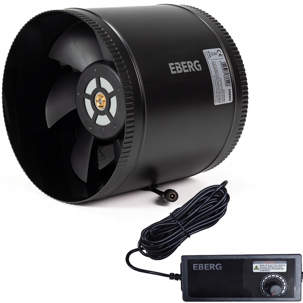

Thanks in advance for your help! Krzysztof RE: KinCony controller to Mushroom farm - admin - 02-22-2025 i suggest you chose kincony F16 controller, here is details: https://www.kincony.com/esp32-s3-tuya-relay-board-16a.html you can connect to your loads directly.it use by high quality 16A removable relay. the temperature humidity sensor chose KinCony TS. CO2 sensor use by 4-20mA or 0-5v signal type. RE: KinCony controller to Mushroom farm - intelligsystems - 02-23-2025 (02-22-2025, 12:46 AM)admin Wrote: i suggest you chose kincony F16 controller, here is details: https://www.kincony.com/esp32-s3-tuya-relay-board-16a.html Thank you for your help! I bought the F16 controller. I will test my project, and I hope to share my results with you soon. RE: KinCony controller to Mushroom farm - admin - 02-24-2025 thanks. RE: KinCony controller to Mushroom farm - intelligsystems - 05-02-2025 Hi, I’ve connected almost all the devices to the Kincony F16, and everything seems to be working as expected. In the meantime, I’ve modified the project because it turned out that it would be better to manage the blower motor speed dynamically using the Home Assistant application. I’m wondering if the https://www.kincony.com/esp32-pwm-dimmer.html would be a good choice for controlling my new blower motor. Here are the technical specifications of the new motor:
What do you think about using the KC868-AP? Would it be a good choice for this motor blower? RE: KinCony controller to Mushroom farm - admin - 05-03-2025 i think it's ok with KC868-AP dimmer board. But you need have a test . RE: KinCony controller to Mushroom farm - intelligsystems - 05-03-2025 (05-03-2025, 07:46 AM)admin Wrote: i think it's ok with KC868-AP dimmer board. But you need have a test . Thanks for your response. I have a question about the Wi-Fi connection. I see in the description that there is a Wi-Fi interface. Since this board will be installed inside a power distribution box, I will need to use an external Wi-Fi antenna. Is it possible to connect an external Wi-Fi antenna to the KC868-AP? RE: KinCony controller to Mushroom farm - admin - 05-04-2025 Is it possible to connect an external Wi-Fi antenna to the KC868-AP? You need cut the pcb wire, weld extend wifi antenna by yourself. another way, you can replace ESP32 module with IPEX socket version. RE: KinCony controller to Mushroom farm - intelligsystems - 05-04-2025 (05-04-2025, 12:44 AM)admin Wrote: Is it possible to connect an external Wi-Fi antenna to the KC868-AP? You need cut the pcb wire, weld extend wifi antenna by yourself. another way, you can replace ESP32 module with IPEX socket version. Thanks for your help. Is it possible to order the KC868-AP with an ESP32 that has an IPEX socket directly from Kincony? RE: KinCony controller to Mushroom farm - admin - 05-04-2025 you can order from our online store https://shop.kincony.com/products/kc868-ap-esp32-pwm-dimmer?_pos=1&_psq=ap&_ss=e&_v=1.0 when you order, leave message , we can replace the ESP32 module with IPEX version, just maybe take 1 week to prepare it. |
