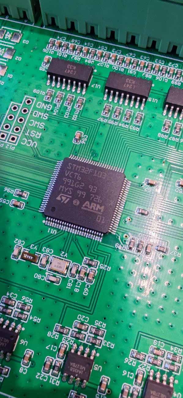

A. if your dimmer controller MCU chip is "STM32F103VCT6" or "GD32F103VCT6" use ST-Link to download bootload HEX file.
Here is ST-link tool for KC868 smart controller firmware update.
https://www.kincony.com/download/sttoolset.zip
when download at stlink software , MCU chip chose what model see the biggest CPU on the PCB bottom side when update KC868-D8 controller.

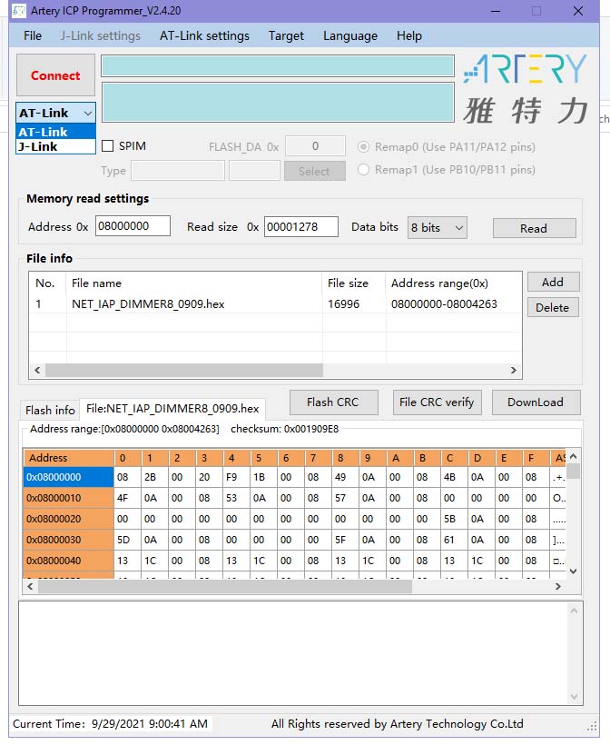

B. if your dimmer controller MCU chip is "AT32F403AVGT7"  use AT-Link or J-Link to download bootload HEX file.
[Image: AT32F403AVGT7.jpg]
Here is AT-link tool for KC868 smart controller firmware update.
https://www.kincony.com/download/ArteryICPProgrammer_V2.4.20.zip
when download at AT-link software , MCU chip model will auto detected when update KC868-D8
if you want to order AT-link usb cable, here is order link
https://www.aliexpress.com/item/1005003336954691.html?spm=a2g0o.store_pc_groupList.8148356.17.16112bd5m3SIcY
if you use J-link, you can also use AT-link's software download firmware by J-link. But we have not sell the J-link.

RE: KC868-D8 V4.34 new firmware update - nmbowerman - 02-11-2022
Hi,
Thanks for your help, I have now received the AT-Link cable, I was just wondering if there is a step by step guide to follow for flashing the KC868-D8 using the AT-link software?
I see it has been requested in a previous post though I could not find any other information, I just don't want to do something incorrect and brick the device.
