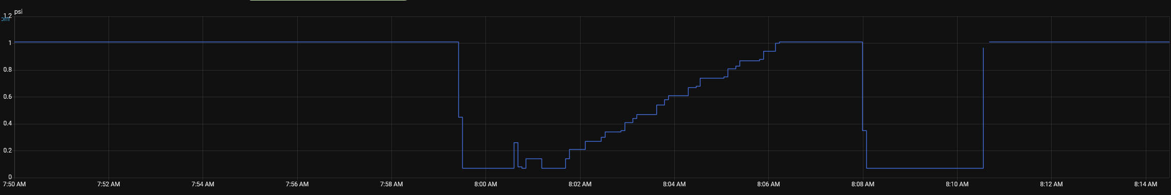

I have the KC868-a6-v1.3sp and a pressure sensor (0..150 psi / 0.5..4.5 V). I noticed my values were being capped at about 40 psi / 1.5 V.
I verified with my fluke loop calibrator, and indeed have a limit at 1.5 V.
The image below shows the raw value being capped at 1.01.
I tried moving the input to the second, but I received the exact same values (capped).
Below code is used for both test with input 36 and 39.
You have any recommendations

RE: KC868-a6-v1.3sp + 0.5V Analog Input - admin - 05-24-2025
you can see this code for analog 0-5v input.
  - platform: adc
    pin: 39
    update_interval: 5s
    attenuation: 11db
    filters:
      - lambda:
          if (x >= 3.11) {
            return x * 1.60256;
          } else if (x <= 0.15) {
            return 0;
          } else {
            return x * 1.51;
RE: KC868-a6-v1.3sp + 0.5V Analog Input - boneless - 05-24-2025
Ah yes, I must have missed the attenuation. Thank you so much, my apologies.
