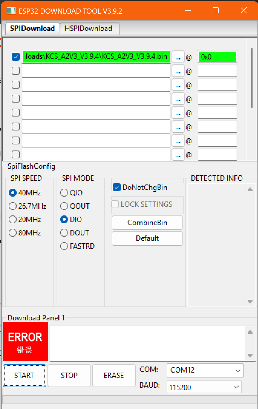

For this reason, I tried to reflash the KCS v3 firmware using ESP32 Download Tool V3.9.2 and entering download mode (turn off → press S2 button → turn on power → release S2).
However, when I press "start" on the ESP32 Download Tool, I get this error:
1 kill
test offset :  0 0x0
case ok
test offset :  0 0x0
case ok
Uploading stub...
Running stub...
[2025-07-12 09:22:45,885][ESP8266Loader_spi[1]][espDownloader.py][line:586][ERROR]: ESP32 Chip stub error esp_stub_and_set_baud.
no log file output ...
I already tested it with different USB cable, different PC and different power supply. But getting always same error.
Here a screenshot from ESP32 Download Tool V3.9.2:
Can you please help me debugging this issue?

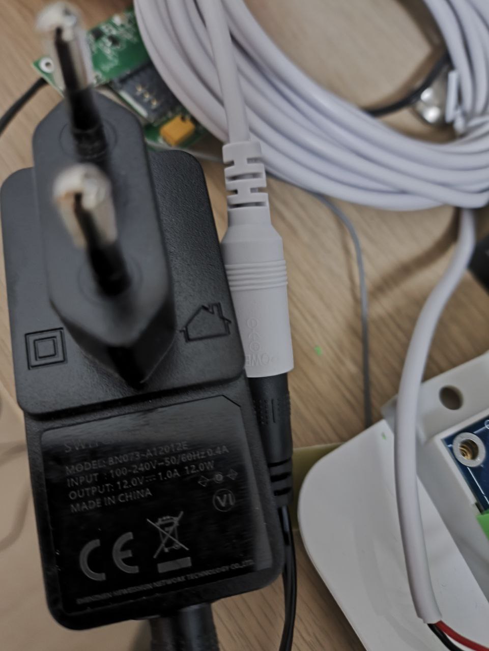

RE: Error Flashing new KCS firmware using ESP32 Download Tool - admin - 07-12-2025
take a photo of your board, how you wire and what power supply you are using.
RE: Error Flashing new KCS firmware using ESP32 Download Tool - steven22 - 07-12-2025
I'm powering it using a 12V 1A power supply.
Also tested with a 9V 1A before.
please change another power supply for testing. we usually use 12v 2A
RE: Error Flashing new KCS firmware using ESP32 Download Tool - steven22 - 07-13-2025
now I also tested a 12V 2A power supply, but still same problem flashing KCS firmware.
