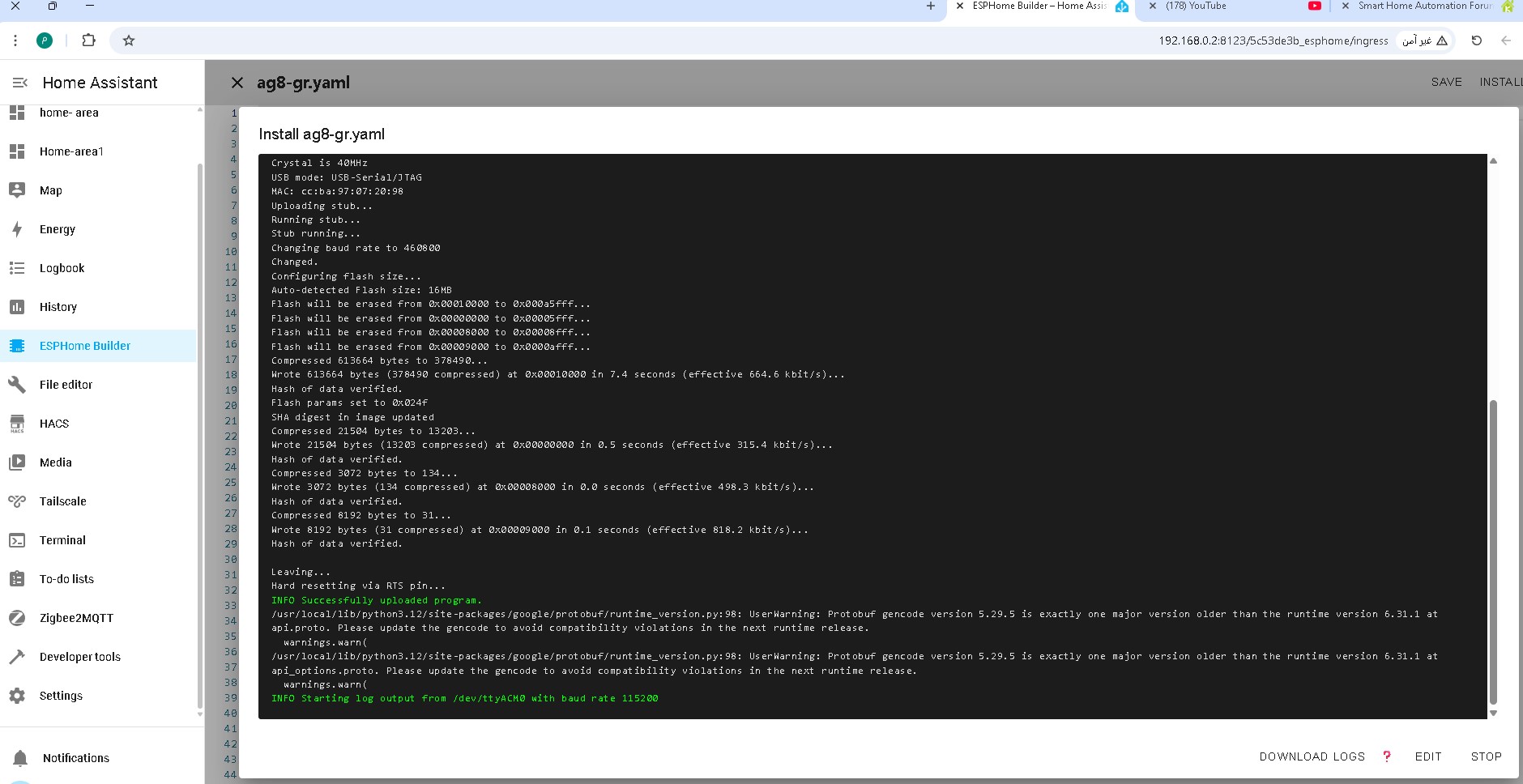

RE: Need Help: ESPHome YAML for AG8 Board to Control 4 Gree AC Units with Temperature - engrezk - 07-31-2025
I have attached the configuration file and a screenshot, but the entities are not showing up. Could you please complete any missing sections in the configuration file if something was left out?

RE: Need Help: ESPHome YAML for AG8 Board to Control 4 Gree AC Units with Temperature - engrezk - 08-10-2025
I have modified the YAML configuration file and it has been successfully executed. The YAML configuration file is attached
