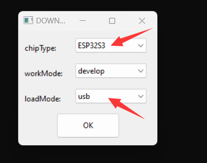

RE: can't connect the A16 board to anything - avihay - 10-22-2025
I am trying to load the KCS board. There is no ESP32 list to upload via USB. I am unable to upload to KC868A16 with RF433. I removed the RF as required and it does not load code.

RE: can't connect the A16 board to anything - admin - 10-22-2025
KC868-A16 use by KCS v2 , use by ESP32, not ESP32S3.
it should be:
[Image: esp32_download_tool_1.png]
here is KCS v2 online guide, you can see this firstly: https://www.kincony.com/esp32-kcsv2-firmware.html
