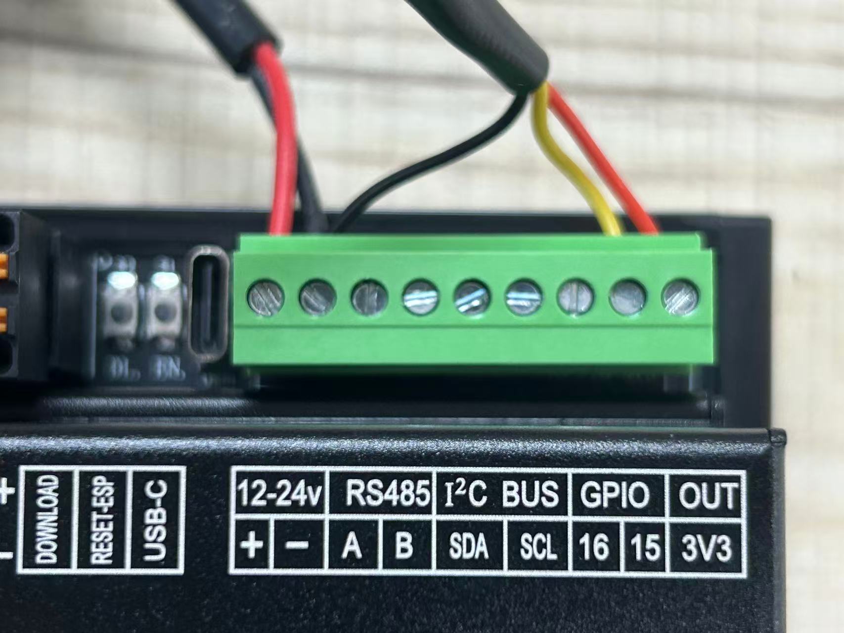

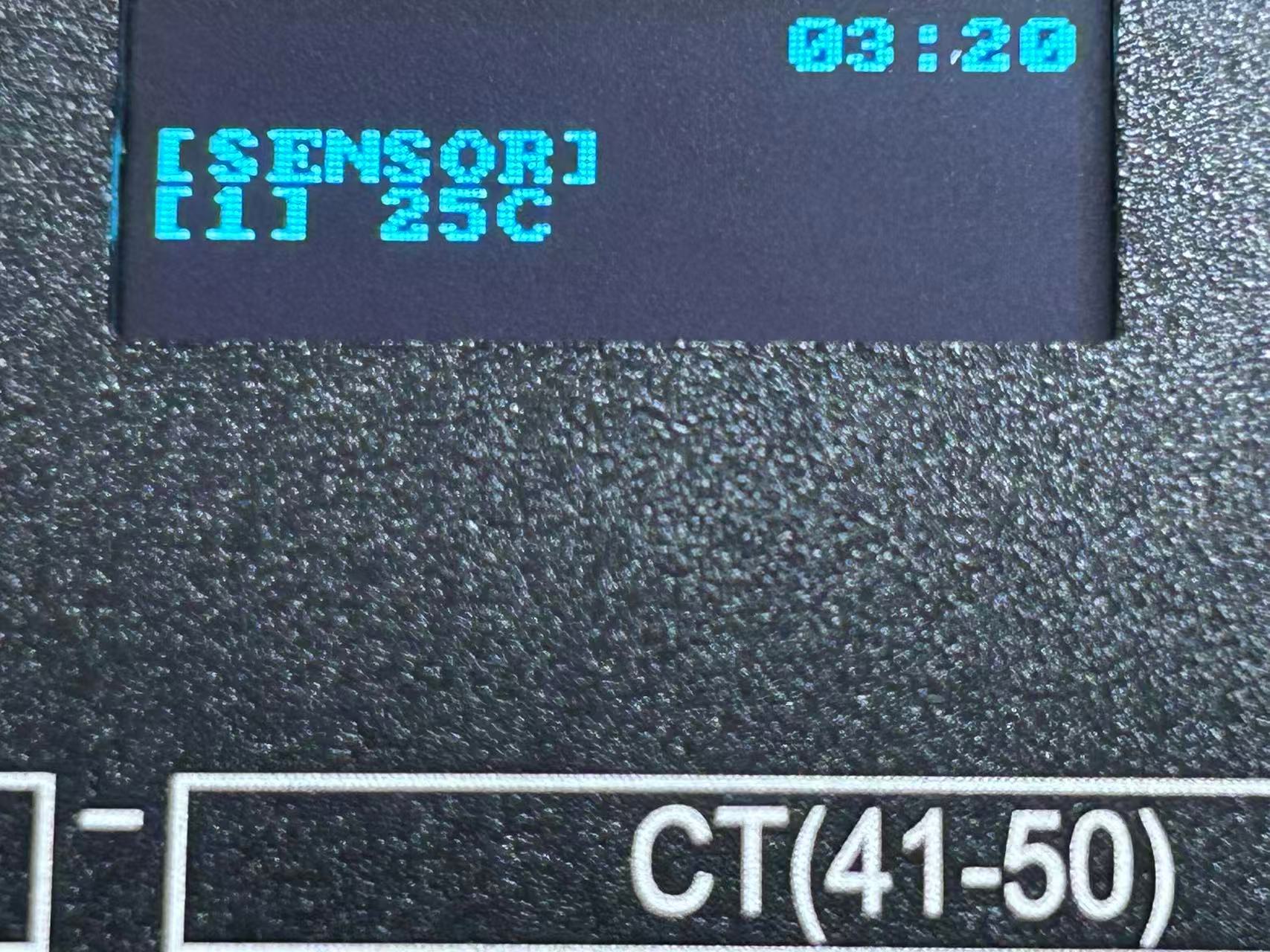

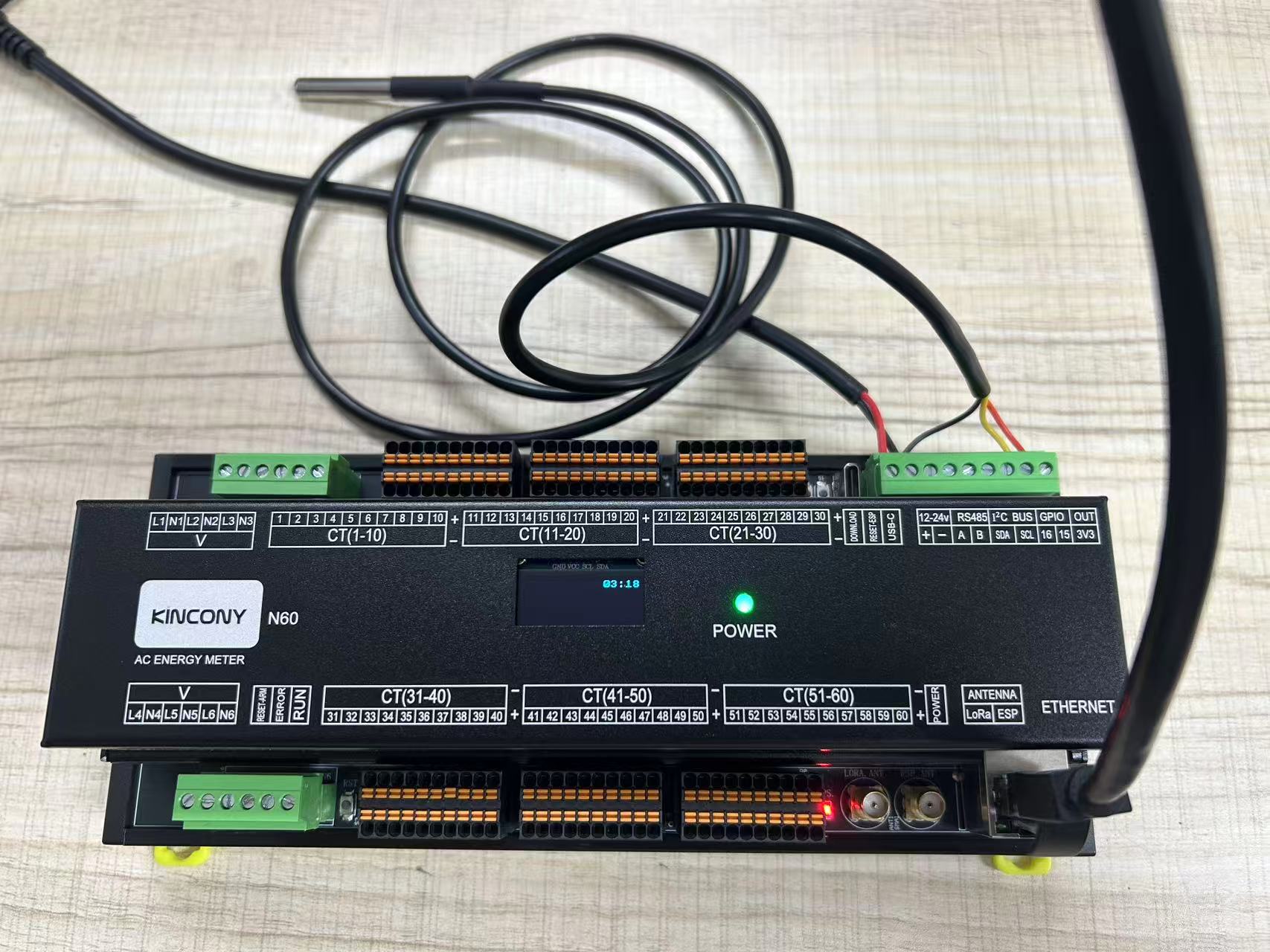

how to set N60 work with DS18B20 - admin - 08-29-2025 in photo, we have connected DS18B20 temperature sensor by free GPIO15. temperature value also showed on OLED display. config by KCS sensor webpage. make sure enabled "pull up" option. temperature data showed on monitor webpage. |
