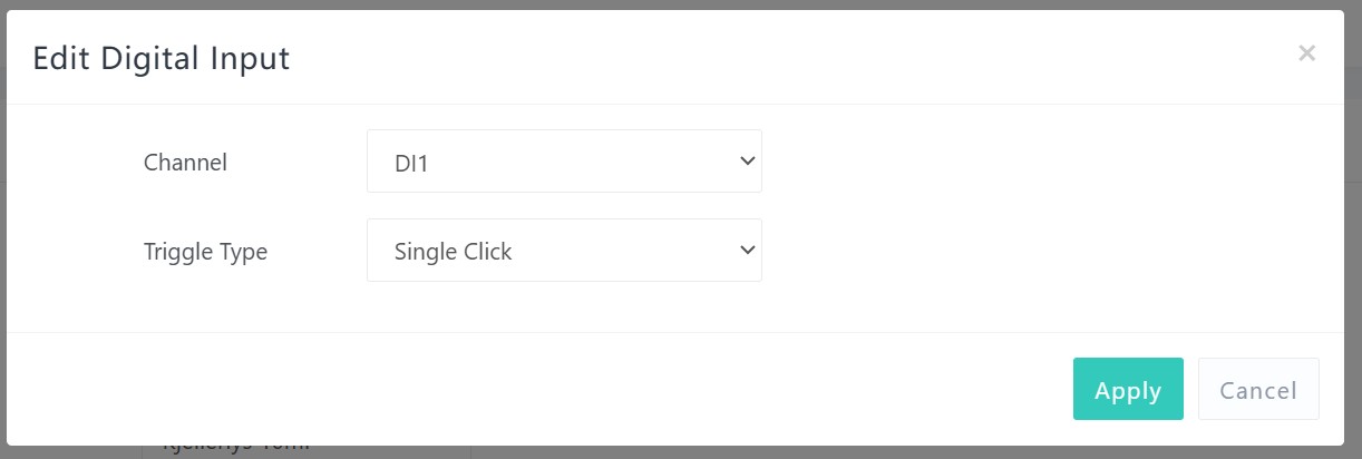

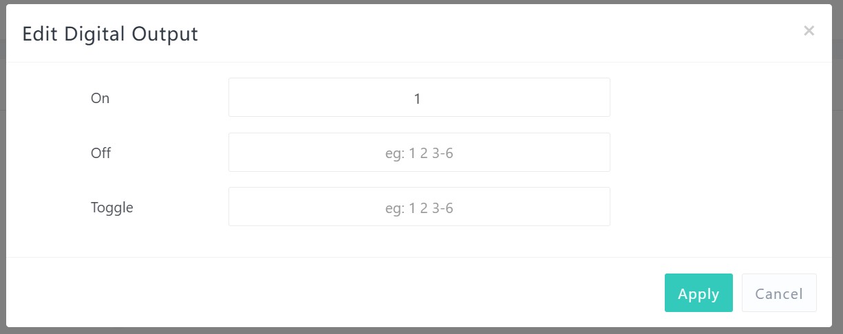

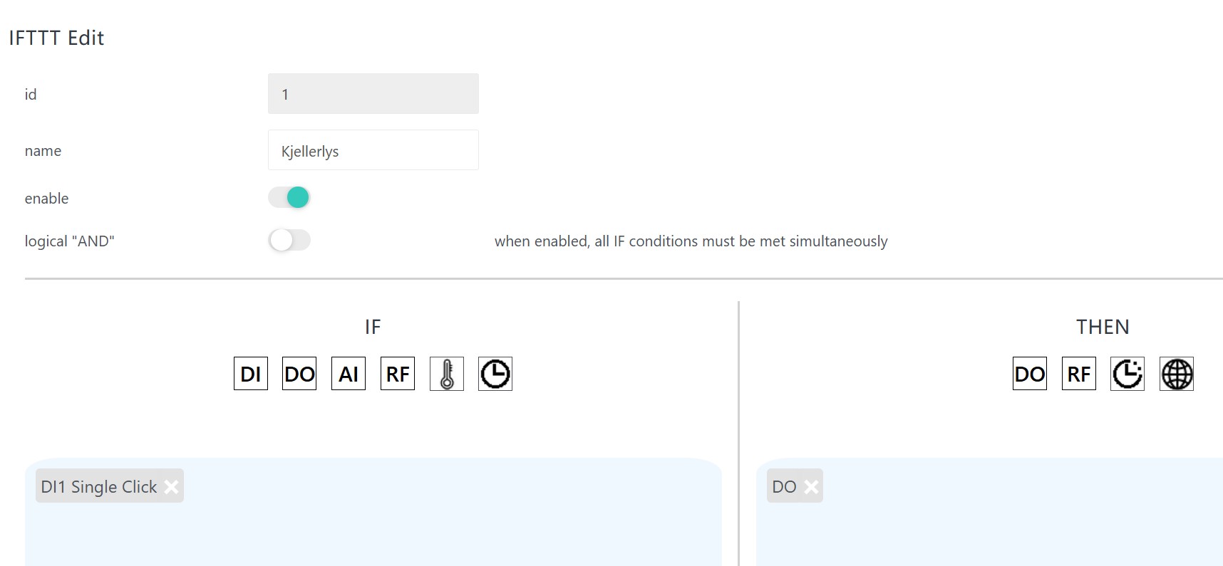

When D1 input is pulled low, the input symbol i the web interface turns green, but the D1 output does not respond. The input push-switches does not do anything. In IFTTT i have: IF DI1  single click, THEN DO 1 ON. When i click RUN, it works fine, but not when i pull DI1 input low og push the DI1 switch. I run firmware version KCS_KC868_E16P_V2.2.14
RE: No output DO1-DO16 - admin - 09-01-2025
1: please chose "Raise edge" for "triggle type".
2: after save ifttt, reboot your board.
RE: No output DO1-DO16 - jeftevag - 09-01-2025
Rising Edge worked fine, thank you Smile
