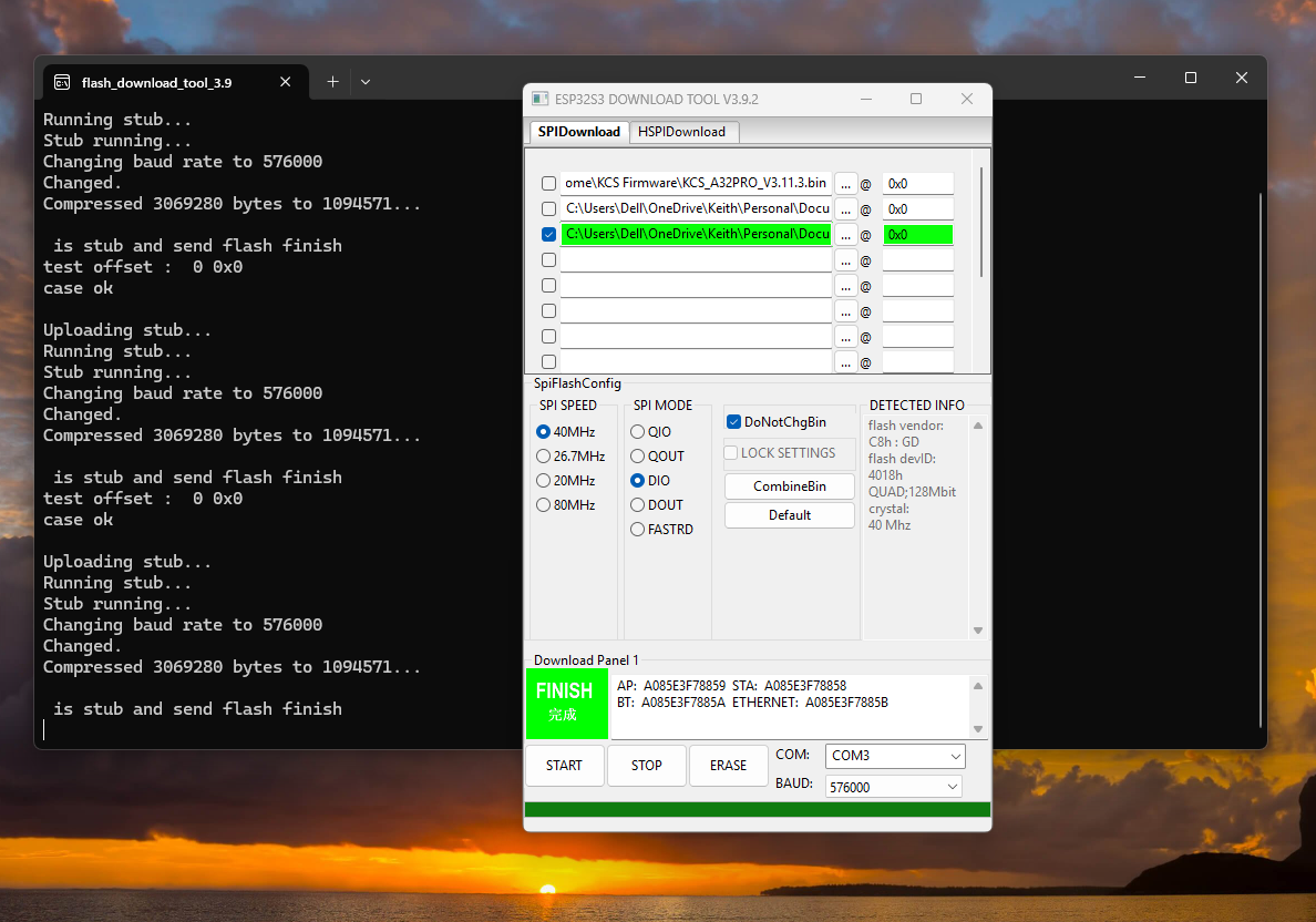

I'm unable to update firmware on my A32Pro.
The flash downloader works fine, ESP32S3, develop, USB.  Port COM3 good.  Start.  Green bar grows, but finishes at 40% (between STOP and ERASE).
Tried holding DL button and turn on device.  No change.
Device now appears to be locked.  No LCD display, no network connection, no Wifi.
How do I restore to factory and or hard reset?

RE: A32Pro Firmware Update Fail - keithc - 09-16-2025
(09-16-2025, 01:33 AM)admin Wrote: 1. power off A32Pro.
2. hold on DW (download) button, don't move your finger.
3. power on of A32Pro
4. release your finger.
5. Then A32Proenter bootloader mode. download firmware again.
I tried that multiple times.  On the A32Pro the button is DL not DW for download.
I press start and the green bar grows, stops at 40%, waits and then flies to the end.
I restart and no change.
The device appears dead.  No LCD, no initial relay sequence, nothing.
Keith

RE: A32Pro Firmware Update Fail - keithc - 09-17-2025
(09-16-2025, 11:44 AM)admin Wrote: it already showed finished. you just need re power on of your controller.
The device was working perfectly 10 days ago.  I put aside before installation in DB. When turned on, no connection.
Video of download
https://1drv.ms/v/c/83a0c66ac59718dc/ESqHb8fZkUNMpQ6E4gbAVNsBAGwYSNmWc0Pq2eEHFZpI5w
The download stops at 40% progress, pauses and races to end.
The device cannot be found on network using UDP Tool, KBox, IP address.
LCD is blank.
No LAN lights.
No wifi link.
I have setup many E16S no problem.  I am not the issue.
What can I do?  Factory flash the ESP32S3?
Regards,
Keith
RE: A32Pro Firmware Update Fail - admin - 09-17-2025
the video showed downloaded 100%, no problem.
where is issue? if you can't download, you can try to change USB-C cable, and lower your baud rate.

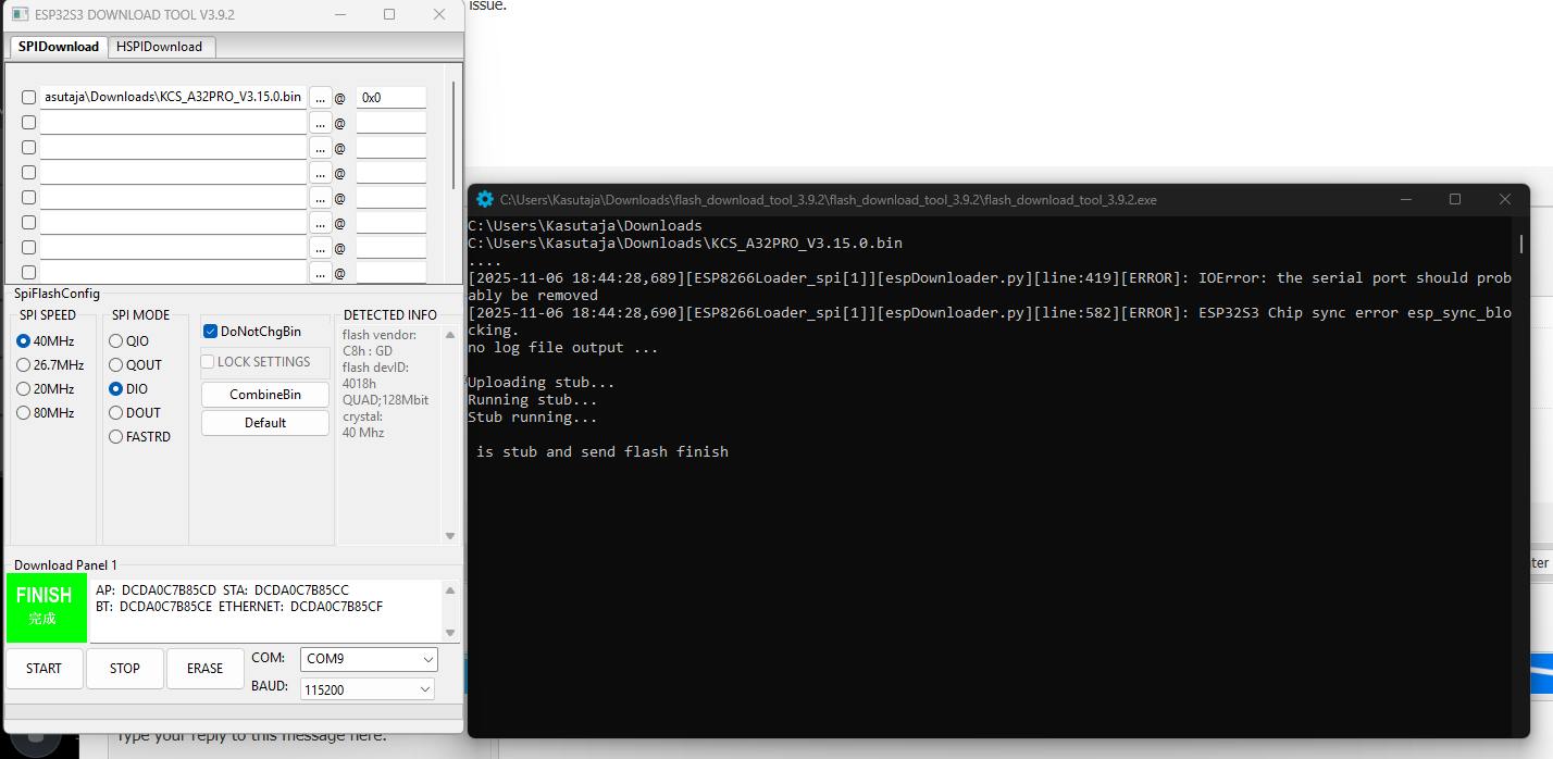

RE: A32Pro Firmware Update Fail - margusveer - 11-06-2025
(09-17-2025, 11:04 PM)admin Wrote: the video showed downloaded 100%, no problem.
Hi!
what was Your solution, I have similar problem - all shows that OK but status green bar don't moving at all
RE: A32Pro Firmware Update Fail - admin - 11-06-2025
you have lose this option, see photo RED.
