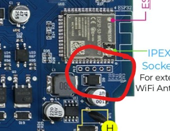

Am I correct :
P39 = GPIO39
P40 = GPIO40
P41 = GPIO41
Finally, Can any of these pins be assigned for TX/RX for D0/D1 with Weigand Protocol?

RE: GPIO numbers for Weigand - admin - 11-22-2025
1-wire (pull-up resistance on PCB):
1-wire1:GPIO47
1-wire2:GPIO48
1-wire3:GPIO38
free GPIOs (without pull-up resistance on PCB):
free gpio-1:GPIO39
free gpio-2:GPIO40
all esp32 pin define at here: https://www.kincony.com/forum/showthread.php?tid=7614
free gpio-3:GPIO41

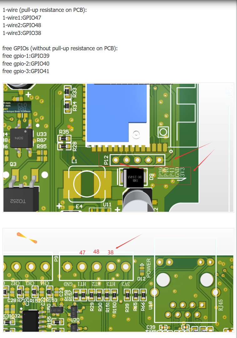

For anyone else that needs the correct GPIO for this board... see:
https://www.kincony.com/forum/showthread.php?tid=7925&pid=21118

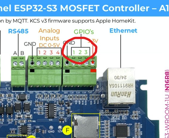

The important image is:
I would like to know what the best GPIO for Weigand...
now I understand the location and PGIO numbering
Thanks.
1-wire1:GPIO47
1-wire2:GPIO48
1-wire3:GPIO38
showed in your RED section. just GPIO-1, GPIO-2, GPIO-3.
GPIO-1=GPIO47
GPIO-2=GPIO48
GPIO-3=GPIO38
