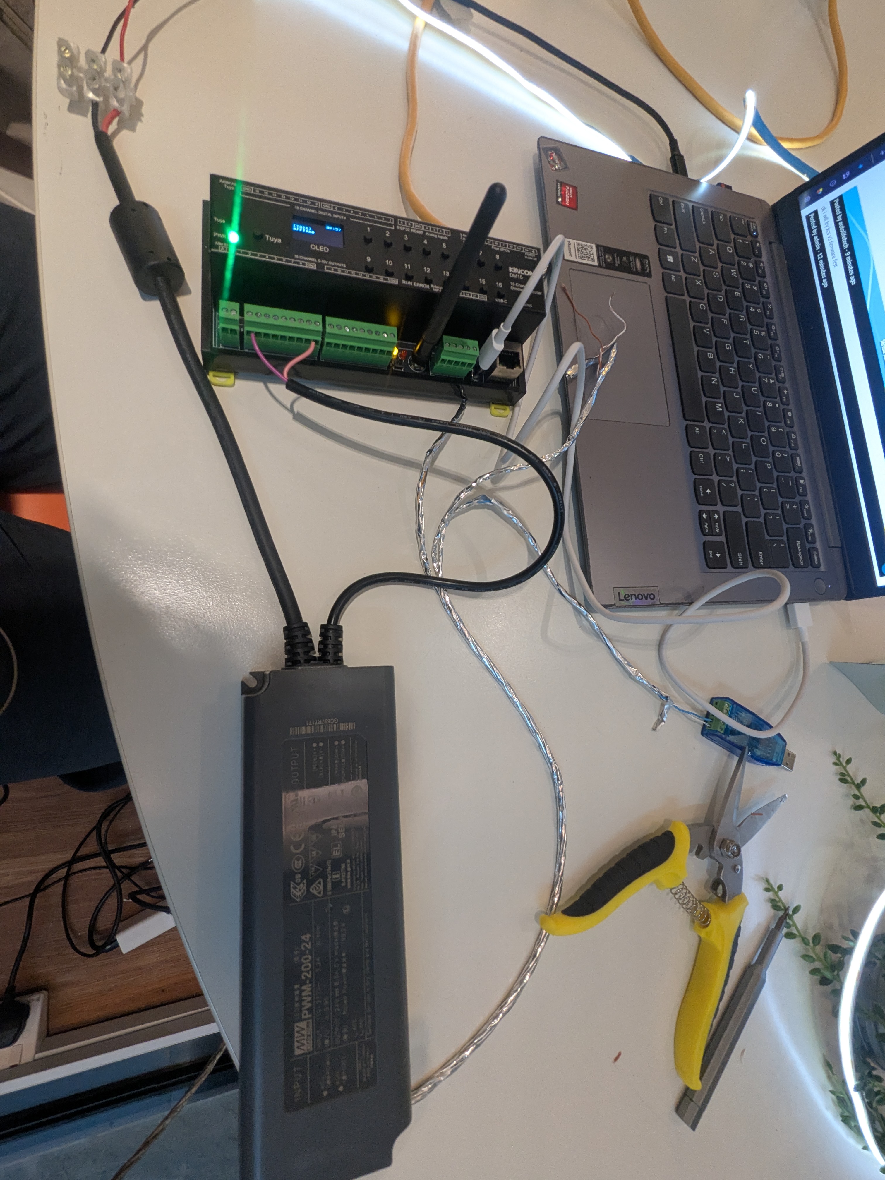

I am using kincony DM16 as controller and Meanwell pwm 200 series for led driver to control my 24V LED strip
I am using the ESPhome code that was provided by you in the forum.
Issue now is I cannot turn the LED off fully when it is at 0%. When I short the wire to GND directly, the light can turn off, but when i use the channel, the light cannot off at 0%. How to solve this issue?

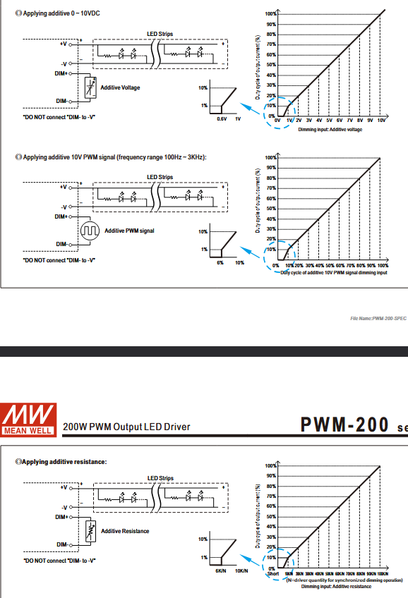

I do not see an issue with the driver because based on the meanwell spec sheet, it is able to take in additive 0-10V, pwm or resistance.
Any other approach that i can do to solve?

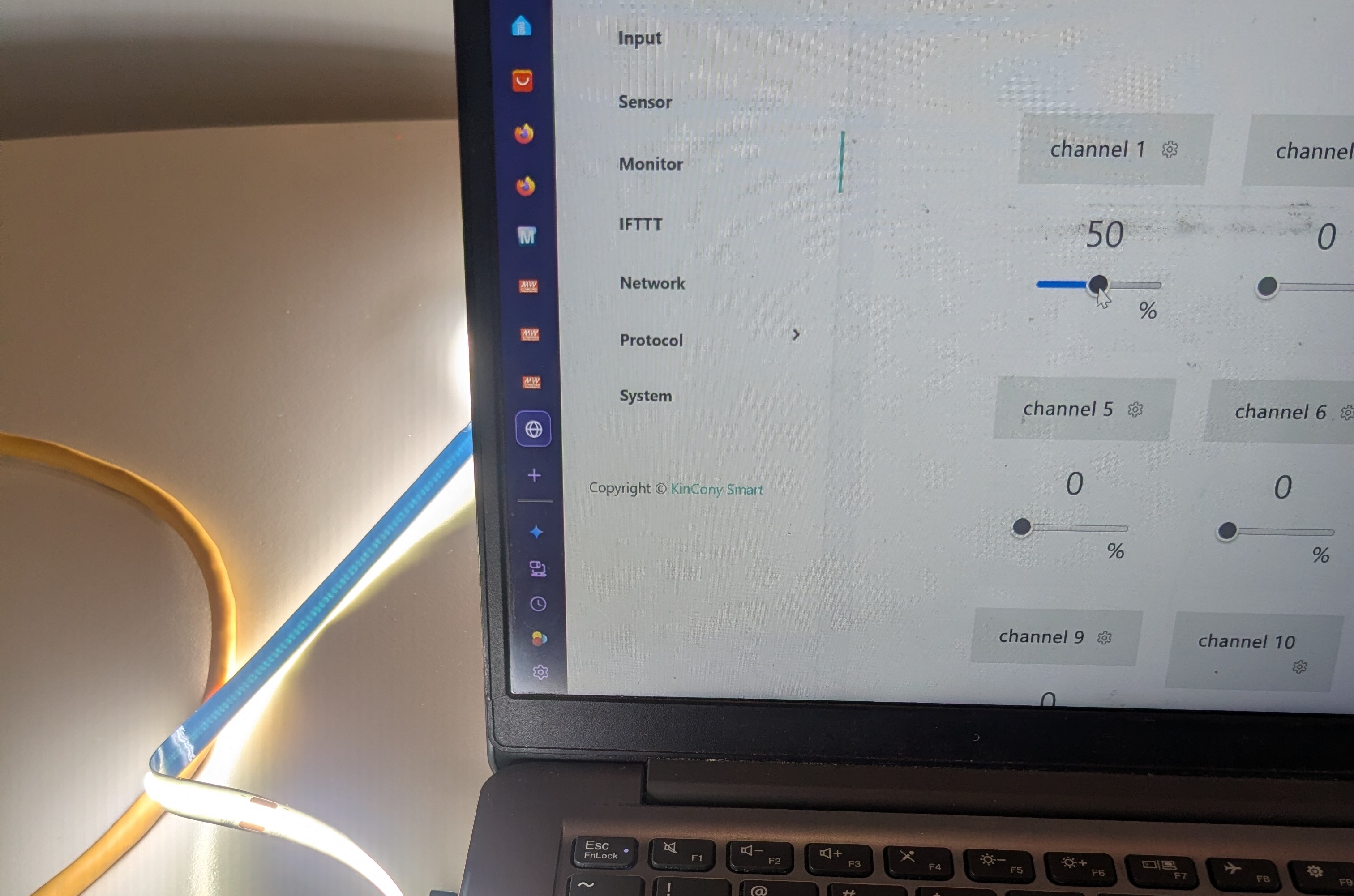

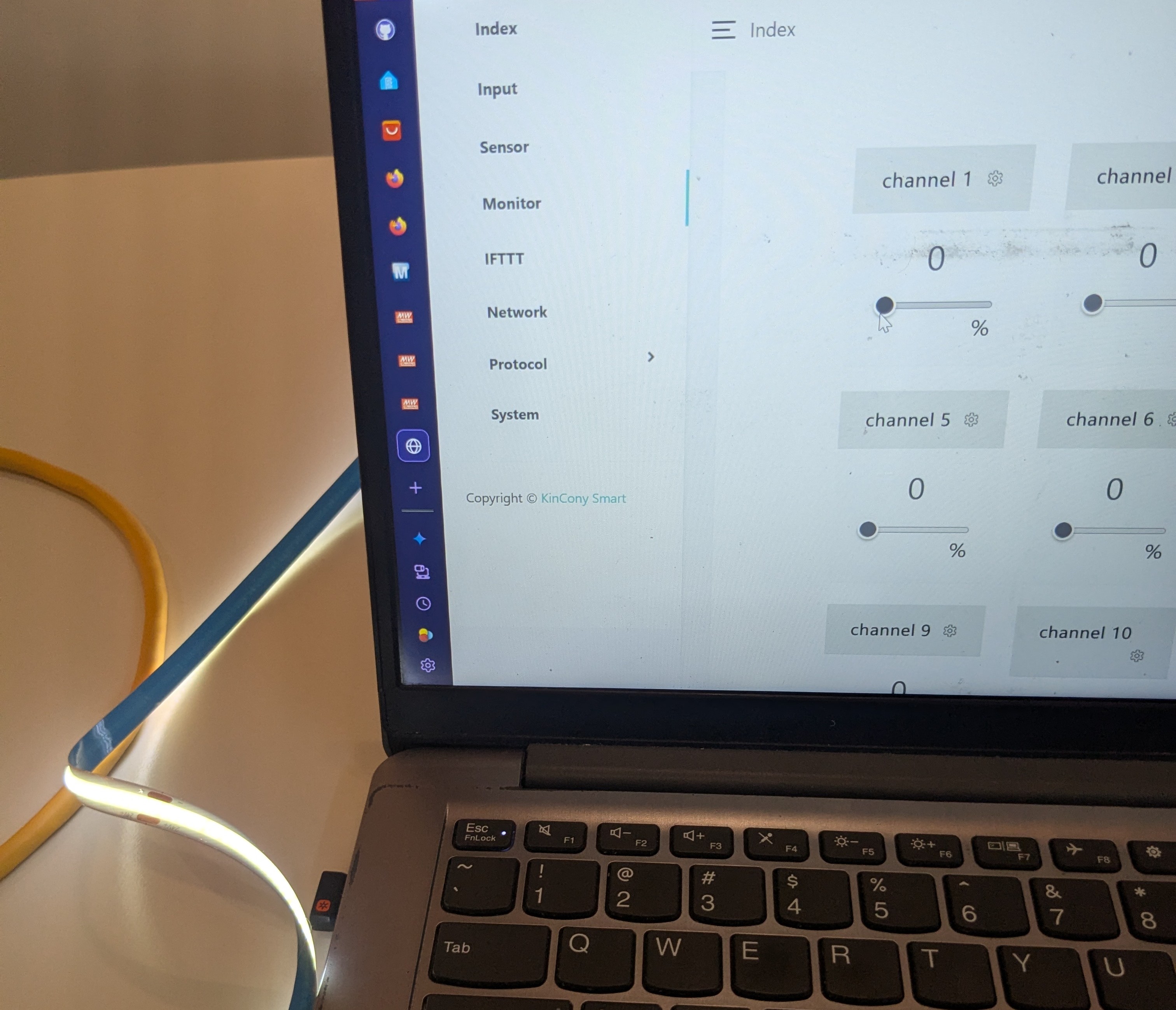

Still same issue

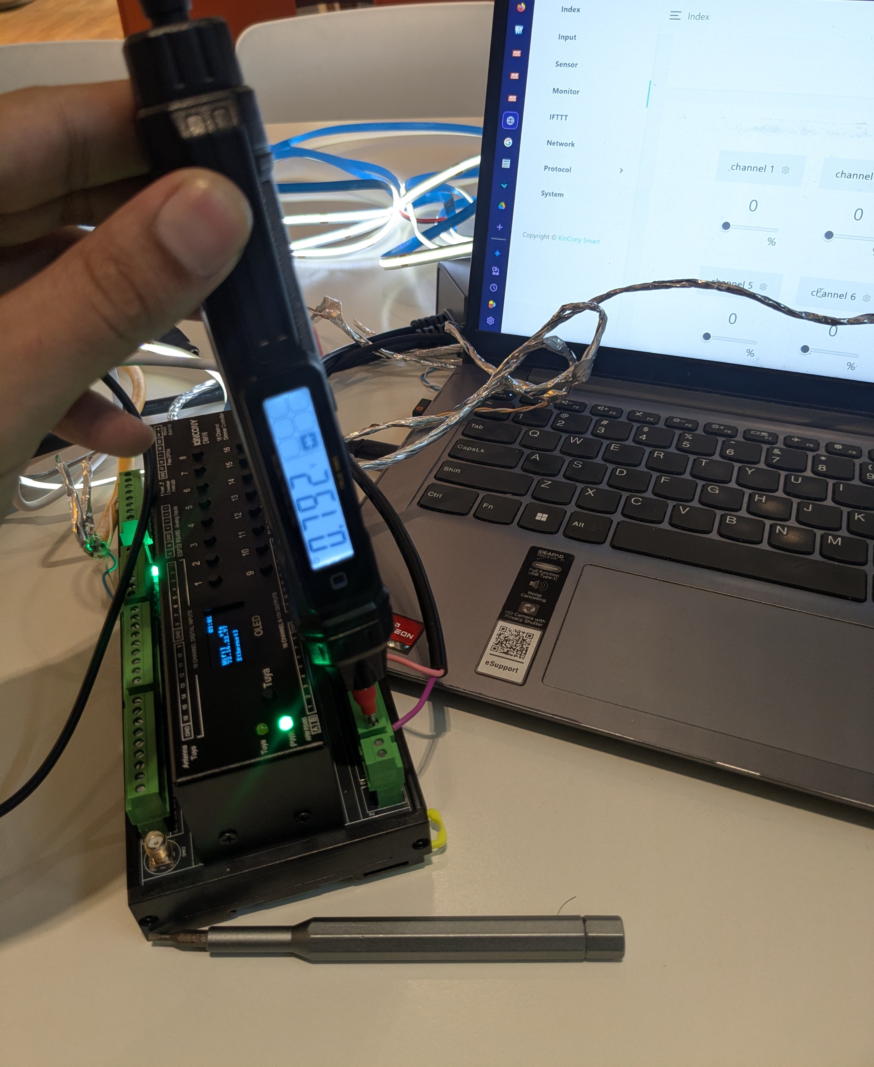

use multi meter to test output port what voltage when turn off in home assistant.

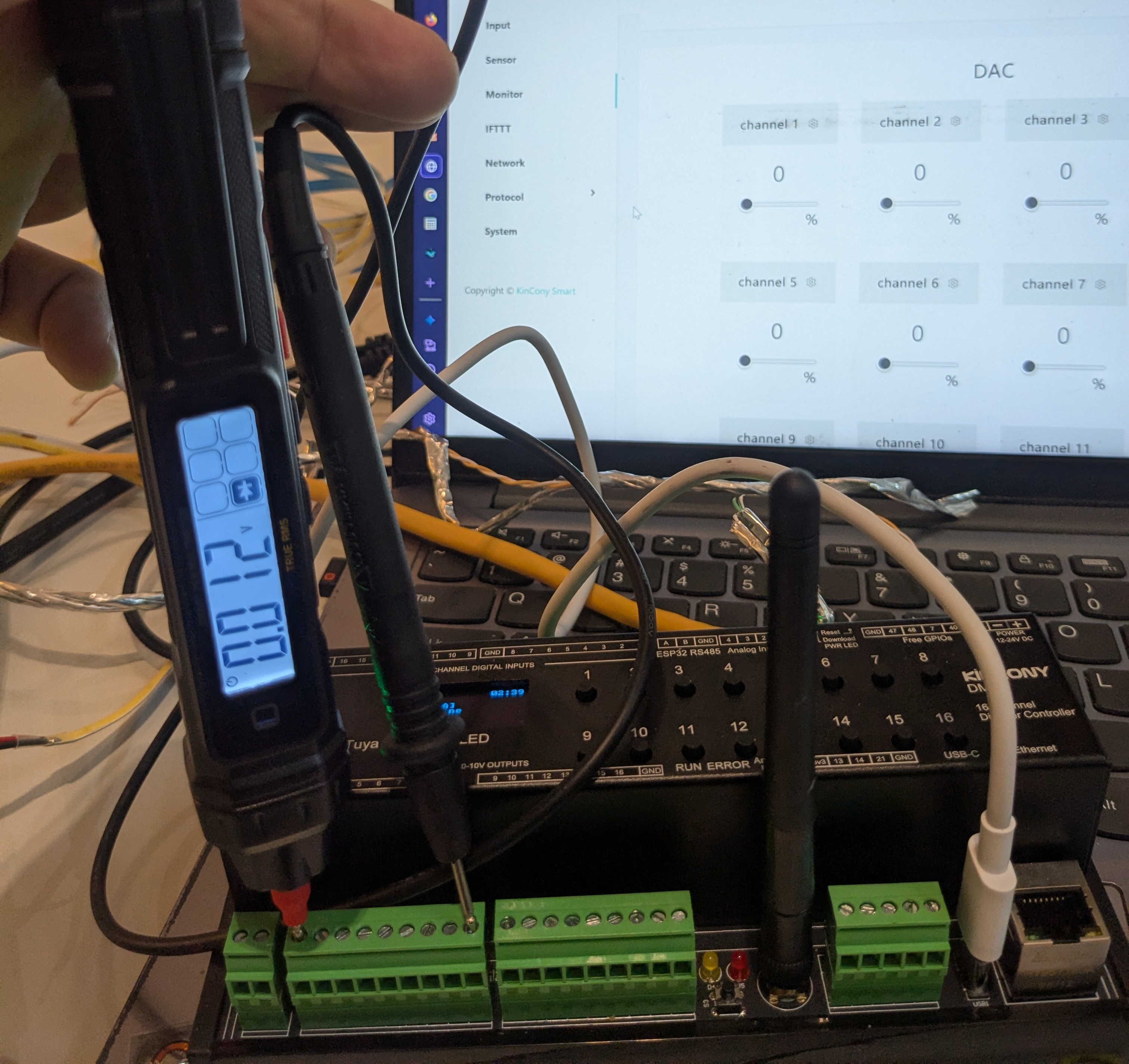

ok here is multimeter reading. When not connected to led driver, it is 0v but when connected, it is 0.7v. Any ideas why?
RE: DM16 output not turning off LED fully - admin - 11-26-2025
i suggest you replace driver. maybe you can series connect a diode to your driver, that will reduce 0.7v. such as 1N4007 diode.
