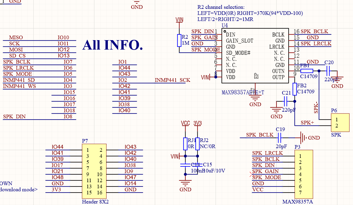

Hi, I am trying to add onto the Kincony AS Voice assistant (hardware) and I cannot find the pinout of the P1 and P2 "connectors" (are they set up for 433mhx transmitter and receiver?)
I have looked everywhere and cannot find any info.
could you please let me know (and add the info to the product web page for others??) what the pins on these "ports" do and what GPIO they area attached to???

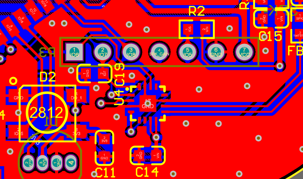

a graphic with all of the solder pads labelled would be most helpful......
RE: Pinout od AS Voice Assistant P1 and P2??? - admin - 12-08-2025

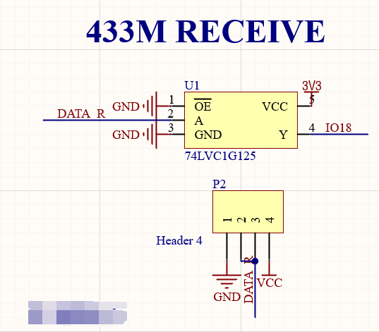

P2 use for 433MHz RF receiver, use by this one:
https://shop.kincony.com/products/rf-433m-wireless-receiver-module?variant=43574707224741
P3 is P3 is MAX98357A pins.
