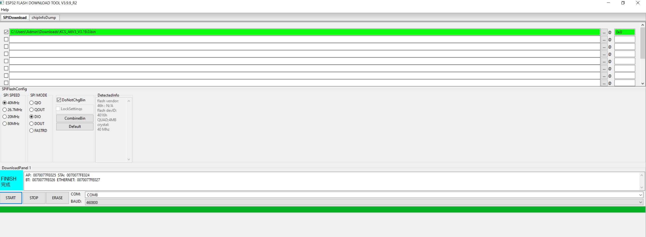

RE: Can't connect using KCS firmware - dalora - 02-16-2026
I should have mentioned I get the following output from the serial port when KCS firmware installed.
I followed your installation instructions exactly.
I got the result shown in attached picture
I get this info from serial

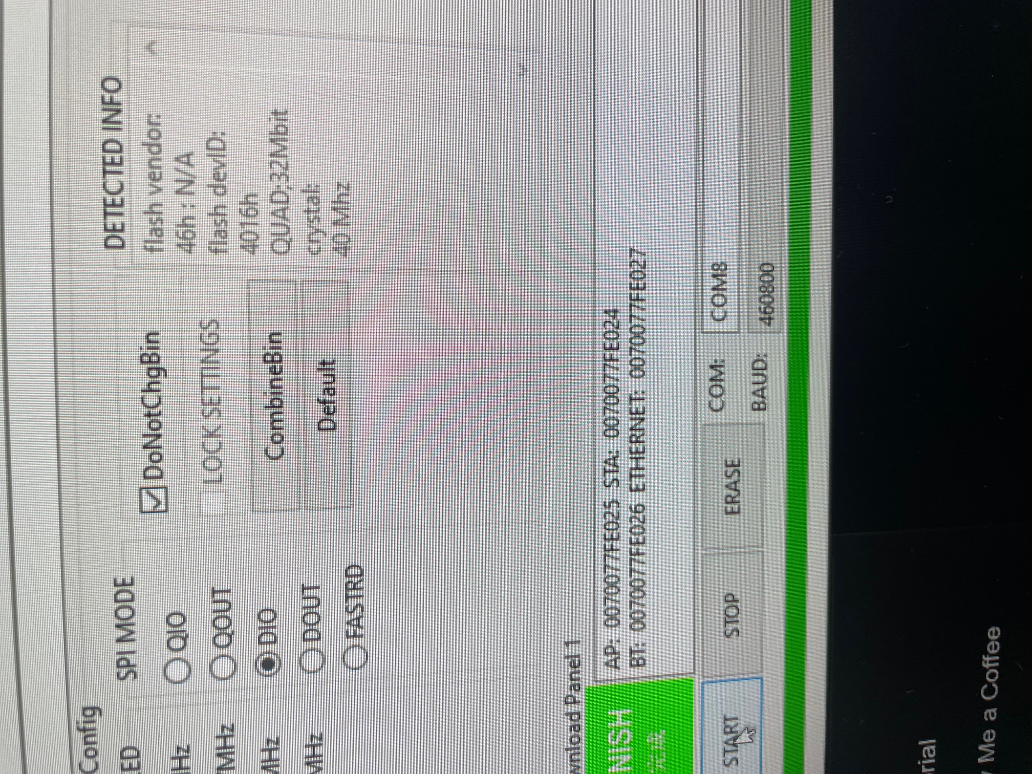

RE: Can't connect using KCS firmware - admin - 02-16-2026
take photo of full screen.
OK , just flashed again and get this result

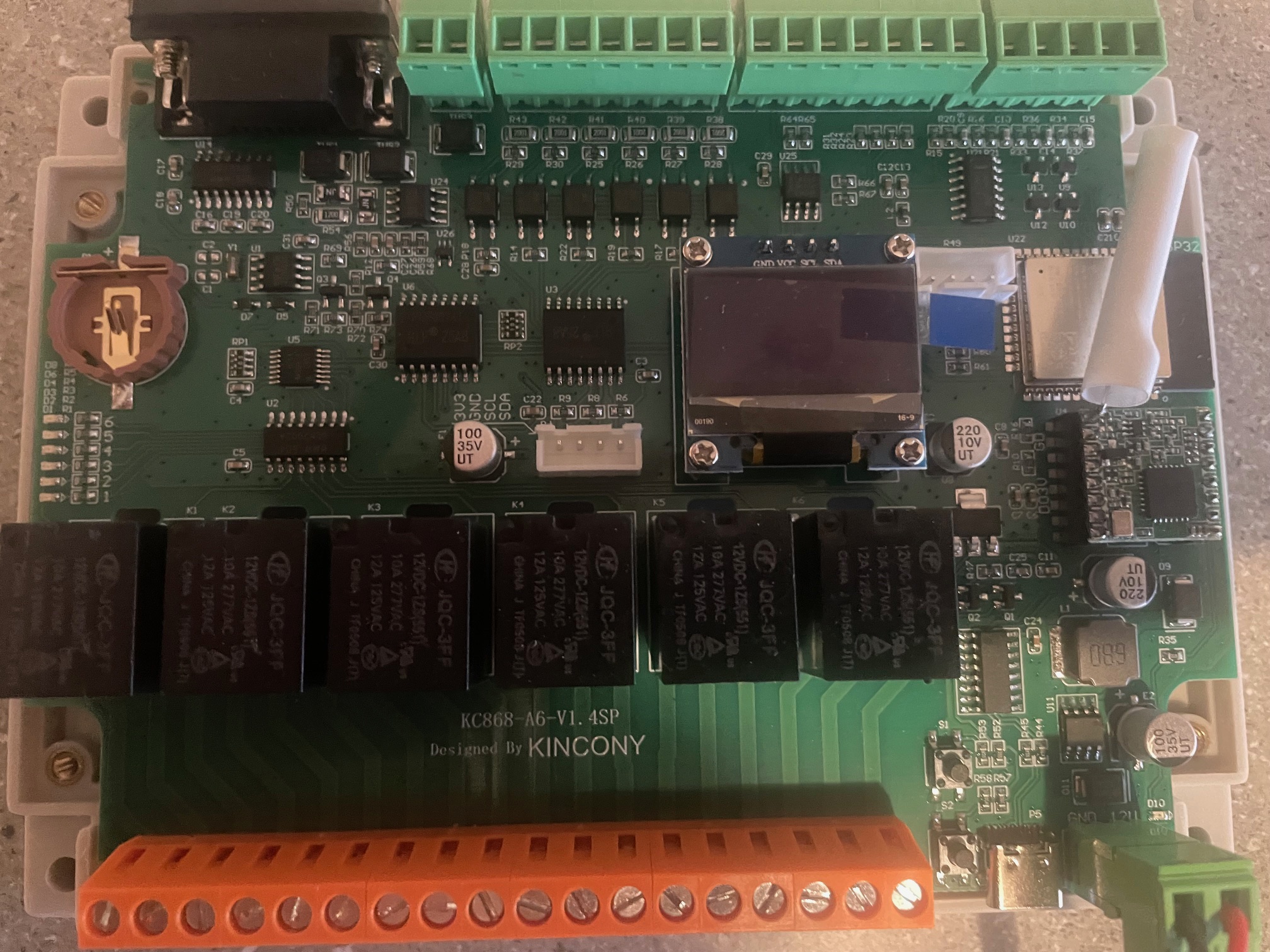

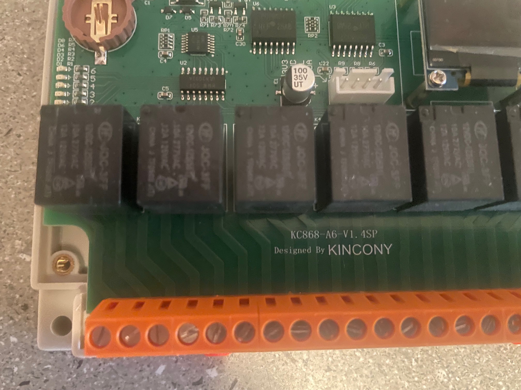

take a photo of your PCB board.
Here are pictures. I have always used ESP32 chip type when flashing as that is what your instructions say
this is KC868-A6 board, NOT KC868-A6v3 board. the A6v3 board is blue color.
you should download KCS v2 firmware for your board. here is link: https://www.kincony.com/forum/showthread.php?tid=8795
