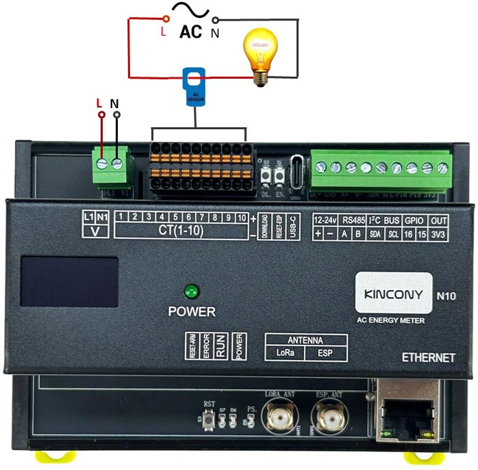

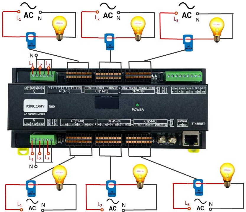

N60 wire case diagram for 3 phase load - admin - 04-01-2026
