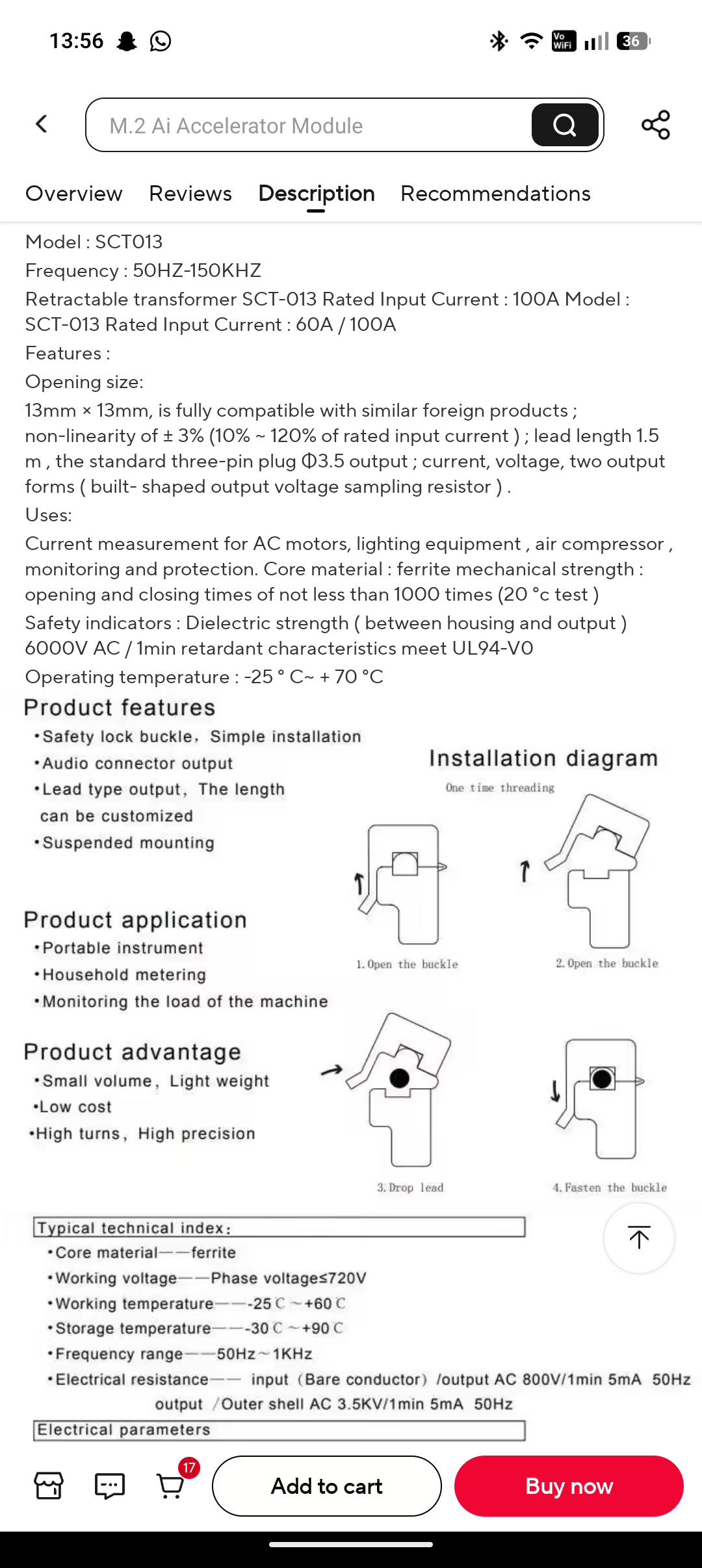

When you mention 2000:1 for CT clamp, what does this mean exactly as my current clamps as shown from original post are 1v and whatever the suitable amp was for specific applications?

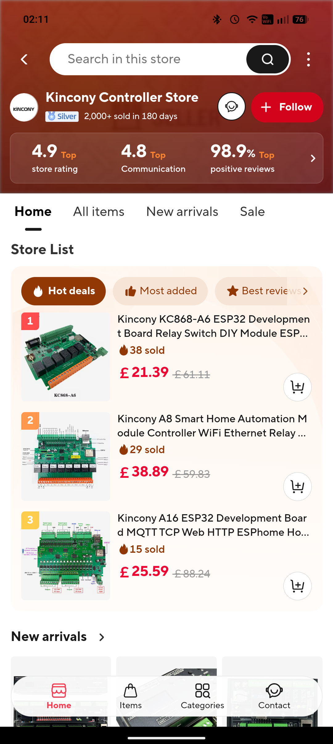

1: i can't find your order number, are you sure order from kincony official aliexpress shop? it's https://kincony.aliexpress.com/store/1100463977
maybe you have bought from our agent. if YES, you need tell us your address or you can contact with aliexpress seller, ask him to send you one N30 board.
2: how to chose CT sensor, here is explained in details: https://www.kincony.com/forum/showthread.php?tid=8488
RE: m16v2 energy meter - calibration issues - PapaC - 04-24-2026
I have attached screenshot of AliExpress store I purchased from, please confirm.
Thank you for info on CT clamp
RE: m16v2 energy meter - calibration issues - admin - 04-24-2026
this is our agent.
