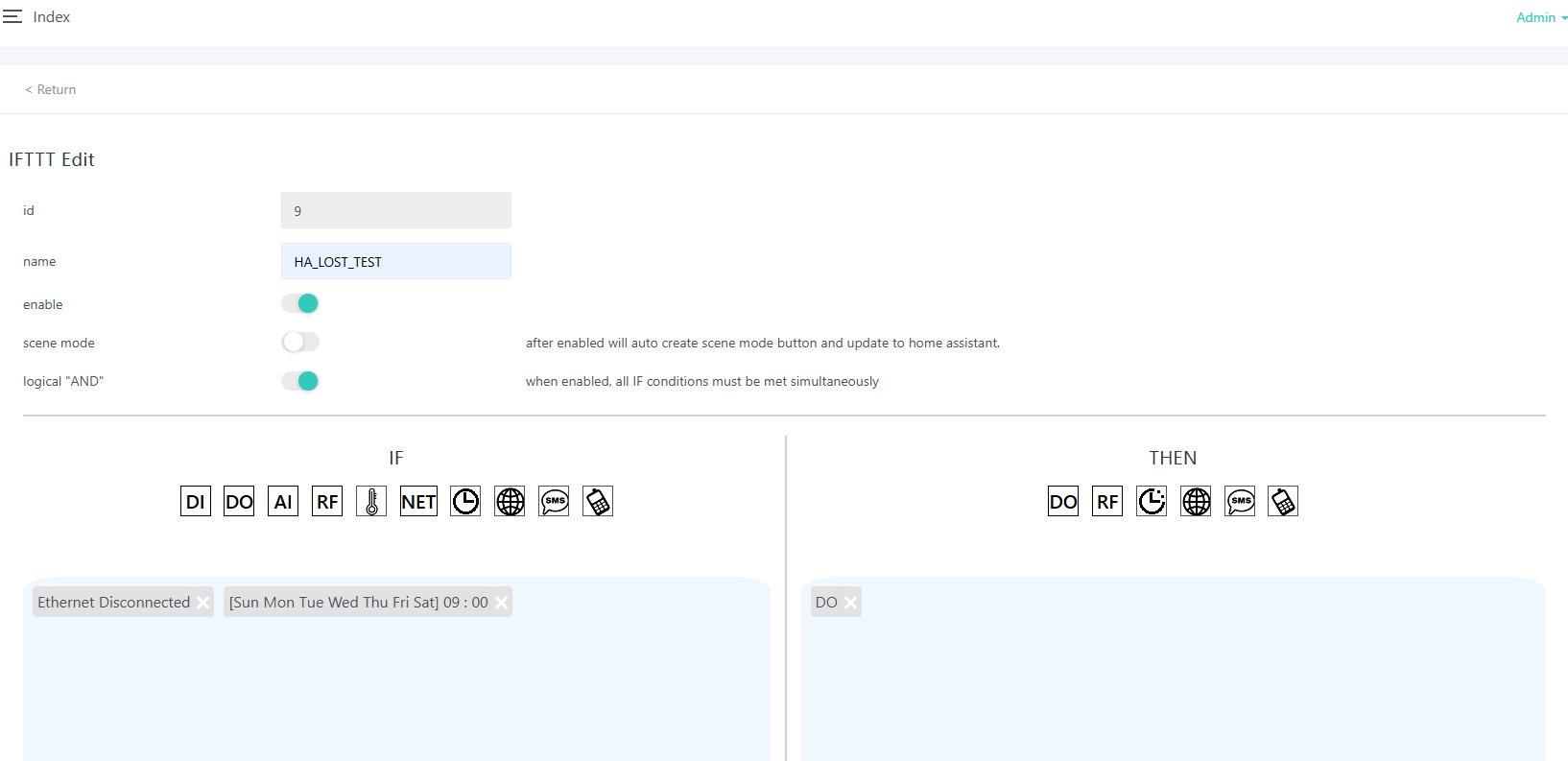

It is not possible to set the logic of operation:
For example, if there is no internet connection and the time is between 9:00 and 18:00, then turn on the fountain.
It is not possible to set a time interval in the condition.
It will check that there is no internet connection, and if the time is 9:01, the condition will not be met.
Thousands of rules need to be set.

RE: KCS v3 - Remote modification of Timer/IFTTT rules from Home Assistant - vsadnik11 - 06-20-2026
(06-20-2026, 12:00 AM)admin Wrote: the timer work in locally without any network.
just preset by IFTTT by webpage, this webpage is local network webpage. not need internet. after set the timer, nevery use network again.
Sorry I may have not expressed myself correctly.
I understand that you don't need an internet connection to set up IFTTT
I am about how to set a condition
If it is between 9:00 and 18:00 then ...
for example, there is no internet connection now (the connection was interrupted), and at the same time, it is 13:07. In this case, execute Output16
as in the picture... only the time interval needs to be
RE: KCS v3 - Remote modification of Timer/IFTTT rules from Home Assistant - admin - 06-20-2026
do you using KC868-A16v3 PCB?
we will update new firmware to support "time_range" for IF condition.
