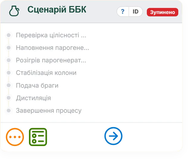

  • scenarios that drive a process stage by stage and only call the operator when a decision is needed;
  • operator panels assembled from buttons and gauges without code, opened from a phone over Wi-Fi or remotely through our cloud (optional);
