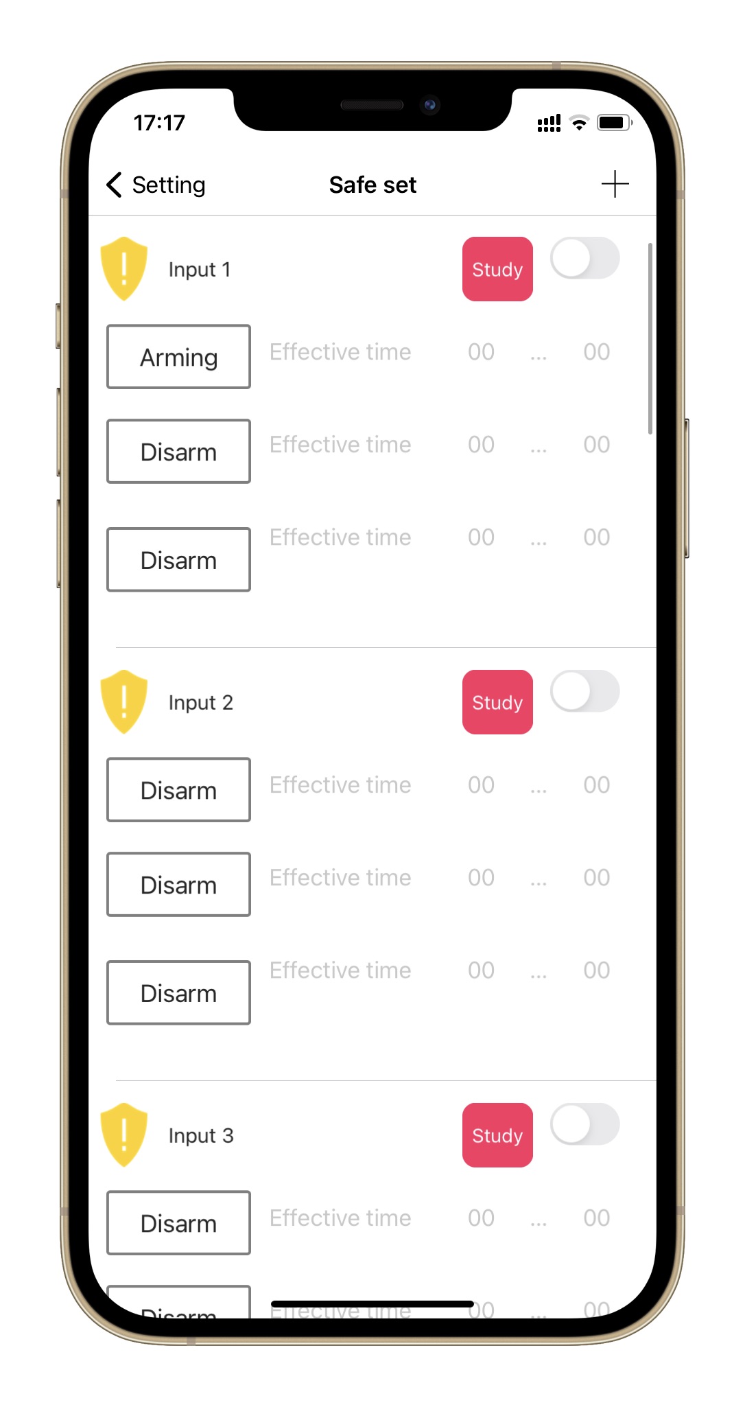

Posts: 109
Threads: 13
Joined: Nov 2020

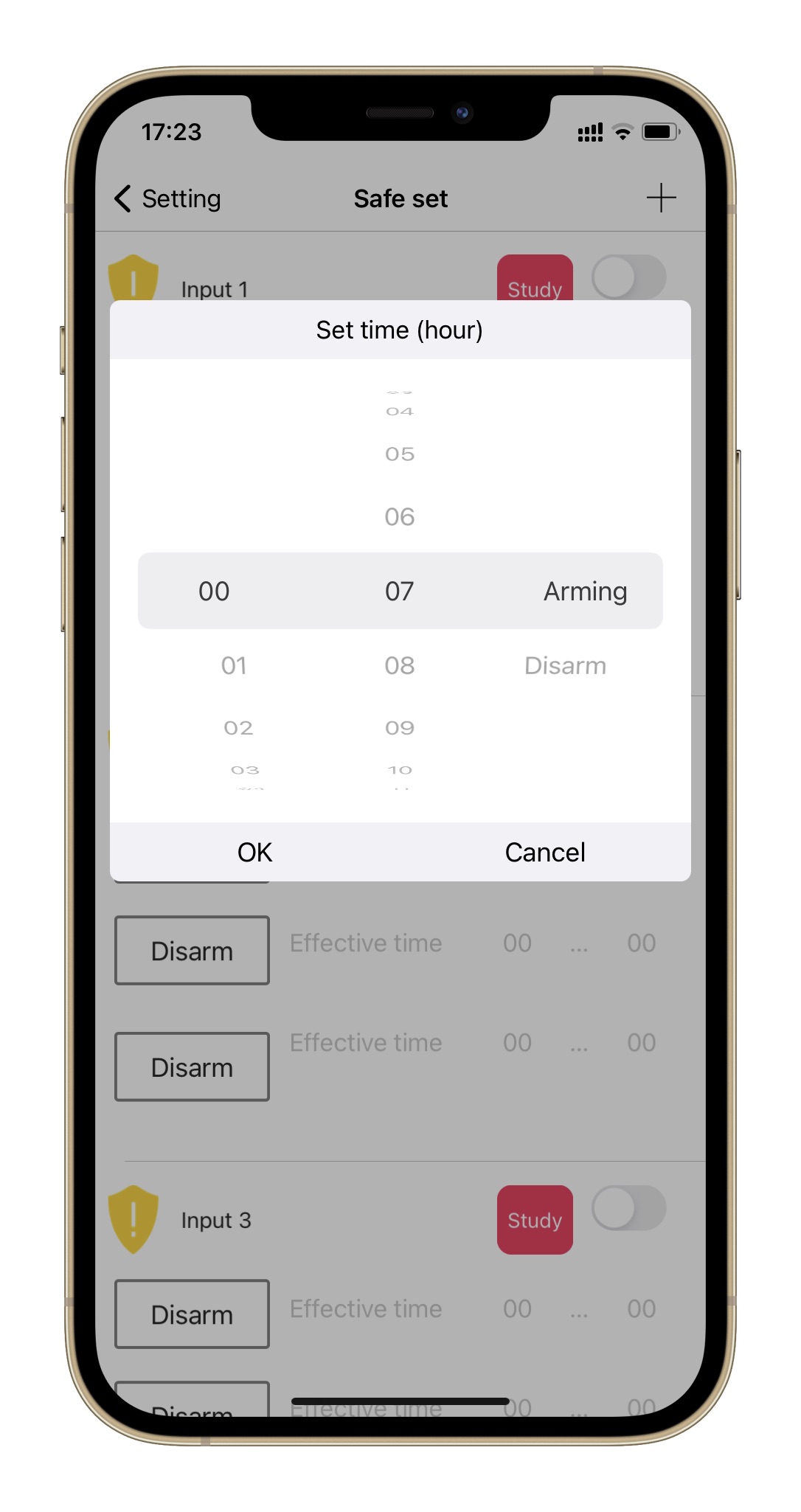

I followed the instructions and was able to program as per the instructions. However, I have two problems:
I can activate the input via "safe set" in the time period I want (sin, it goes to hours ... no minutes) but then the light scene goes on ... but it does not turn off after 20 seconds as I would like.
in addition, every time the smart home alerts me via notification. I would like it to be optional
Posts: 10,474
Threads: 1,560
259
because you have enabled the alarm message function, just disable is ok.
you can add our technical support whatsapp number: +86-13336170682 take a video send to him that how you set. he will help you how to do.
