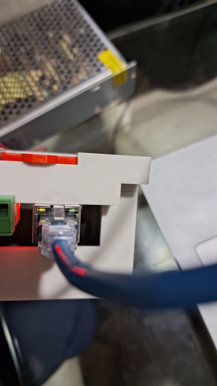

i have the KC868-A16 REV:1.6 new and try to connect ethernet port and no open or no can see the lights, and connect to Router or my laptop, none show the ethernet port connect.

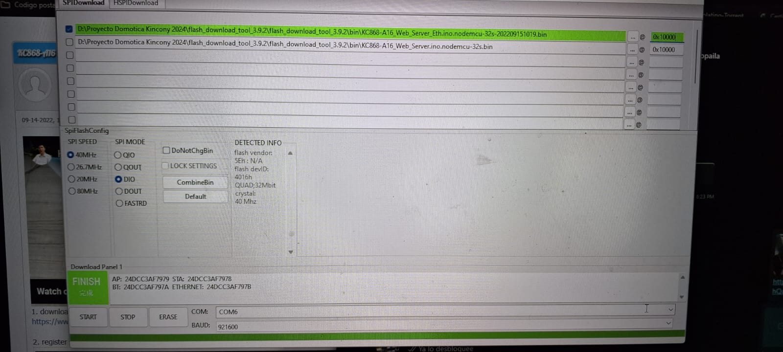

download the firmware "KC868-A16_Web_Server_Eth.ino.nodemcu-32s-202209151019.bin" install whit a ESP32 Download Tool, reboot and not see any change its the same
add these 1-3 item files.  download every zip file, unzip it, will have the BIN file.
.zip   boot_app0.zip (Size: 200 bytes / Downloads: 789)
.zip   bootloader_dio_40m.zip (Size: 11.35 KB / Downloads: 784)
.zip   default.zip (Size: 266 bytes / Downloads: 765)
With these files works, and try with the firmware "KCS_KC868_A16_V2.2.2" and works fine but try the firmware "KC868-A16_Web_Server_Eth.ino.nodemcu-32s-202209151019.bin" but does not works. can i install the firmware "KCS_KC868_A16_V2.2.2" and connect to alexa?

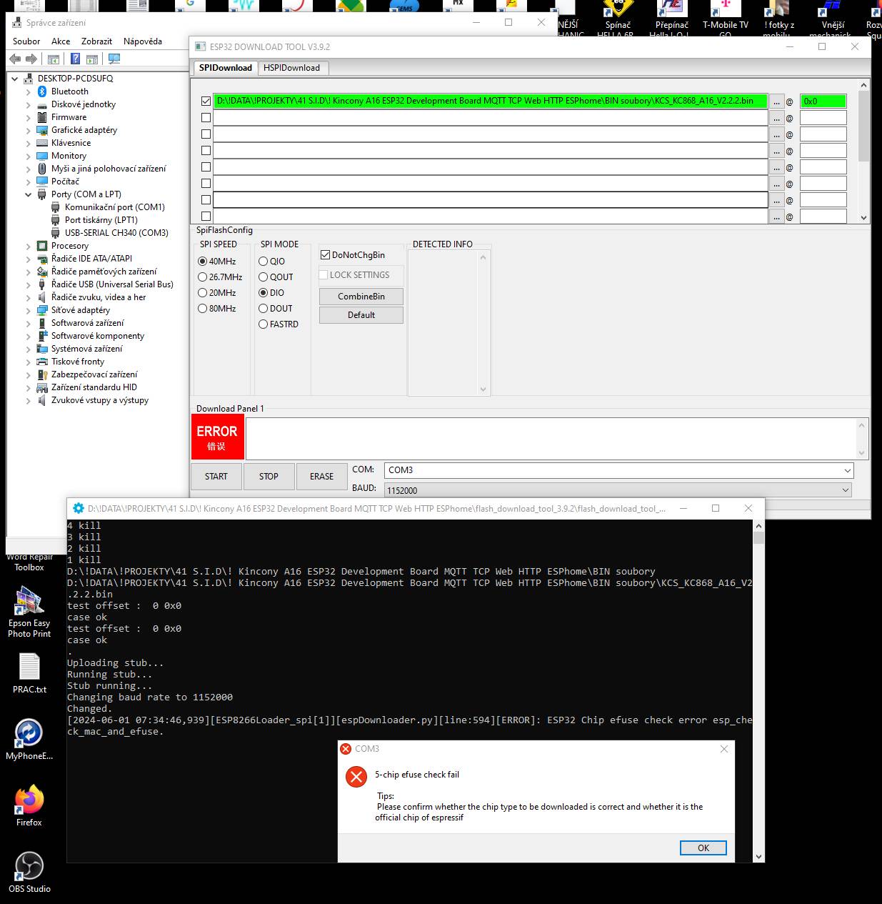

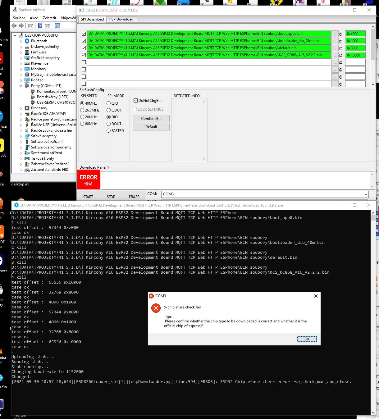

Following the procedure in https://www.kincony.com/esp32-kcsv2-firmware.html I used "flash_download_tool_3.9.2" to download BIN files to KC868-A16. My attempt to download has two variants - see the attached screenshots. Can you advise me where the problem is?
not need check 4 files option. only enable KCS_KC868-A16V2.2.2.bin the address set to 0x0
OK.
I made new download with only one file as you suggested. the result is the same .... ERROR

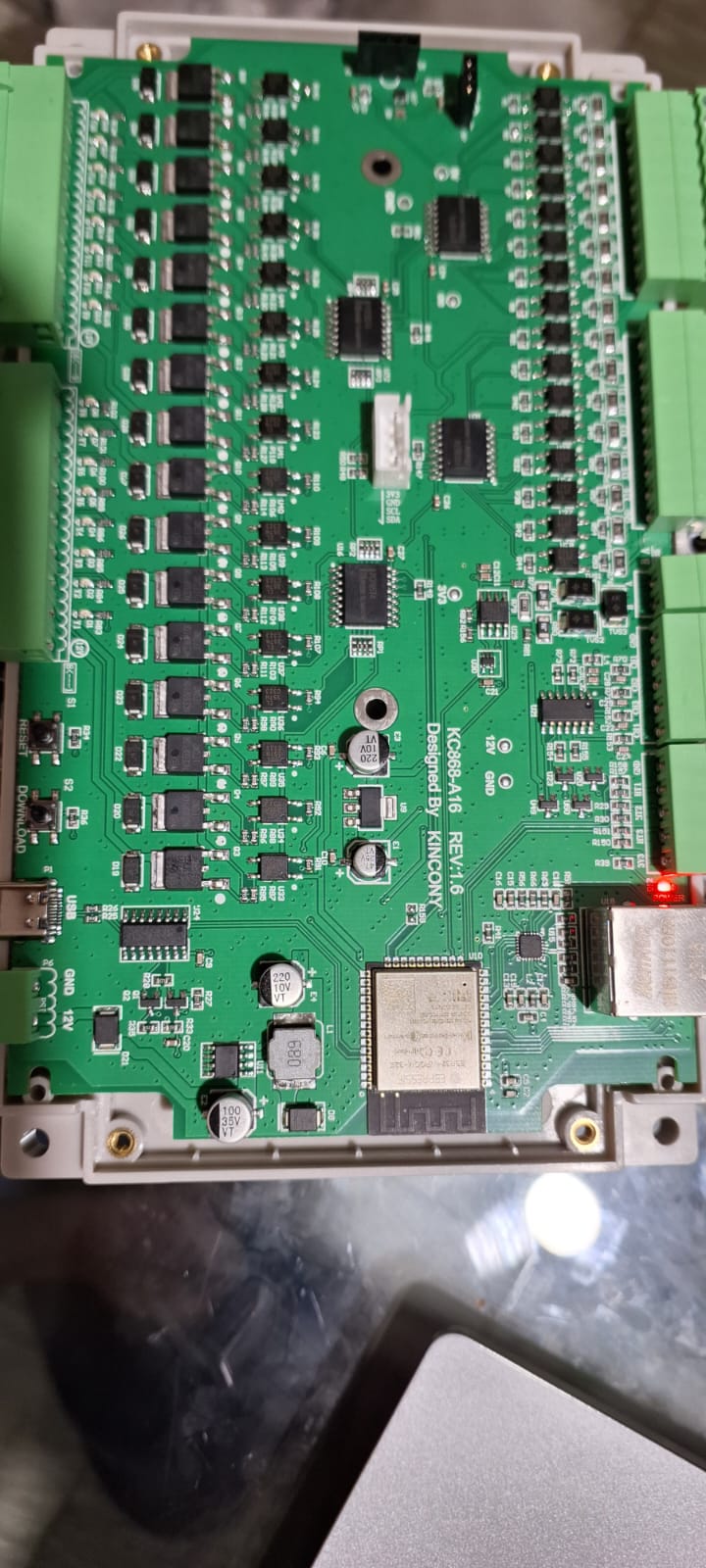

the purchased module is KC868-A16 REV:1.6
take a photo of your A16 board.
