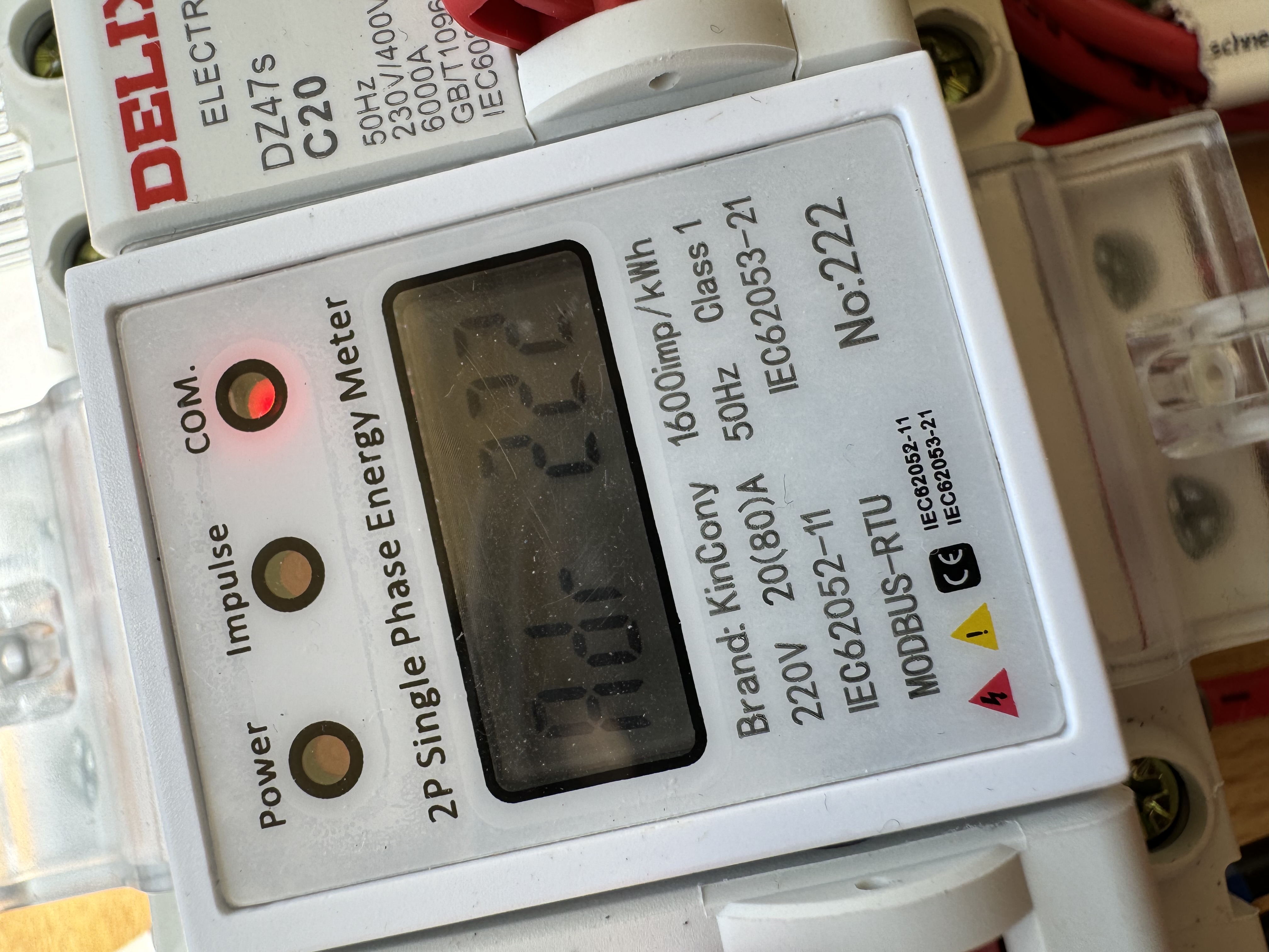

I believe no. When I power on the energy meter I see Addr 222.  When I change slave to 222 I see this:
2024-02-06 12:21:05.145 DEBUG (SyncWorker_7) [homeassistant.components.modbus.modbus] Pymodbus: hub1: Error: device: 222 address: 142 -> Modbus Error: [Input/Output] No Response received from the remote slave/Unable to decode response
2024-02-06 12:21:40.375 DEBUG (SyncWorker_8) [homeassistant.components.modbus.modbus] Pymodbus: hub1: Error: device: 222 address: 144 -> Modbus Error: [Input/Output] No Response received from the remote slave/Unable to decode response

i have post all details steps at here: https://www.kincony.com/forum/showthread.php?tid=4339
you just need set energy meter --> Parity: NONE
home assistant not support "Parity: EVEN".

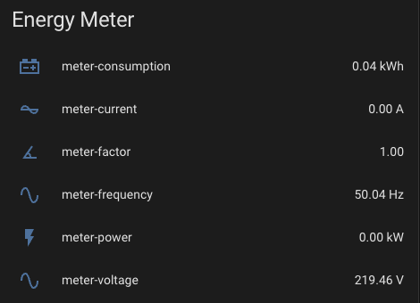

Hi Kincony, I'm having issues with this modbus meter since I set it up as you indicated me.
For months, the meter-consumption is showing 0.04kWh and not changing value. The only parameters that are showing correctly are the meter-voltage and meter-frequency..
How to fix it?
Attached is a screenshot and this is my config:

#18
already repied in your another thread.
#19
don't post repeat topic again, i have said many times.
