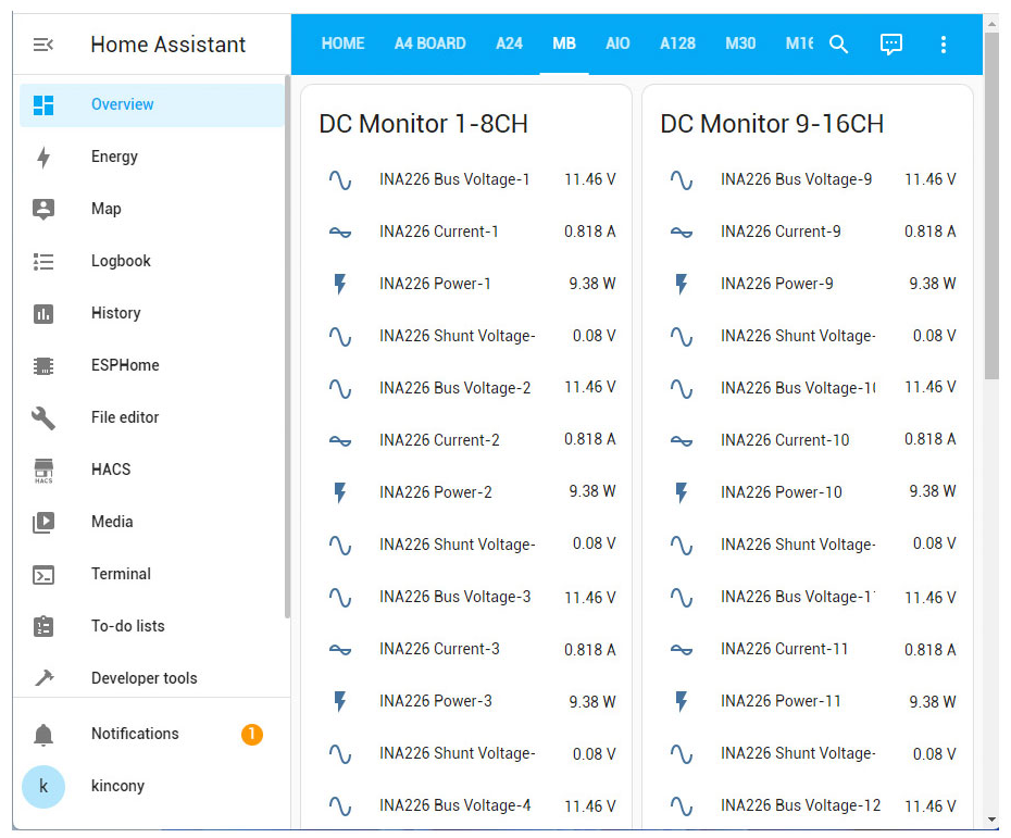

KinCony MB ESP32 Battery Monitor board configure yaml for ESPhome
.txt   MB_HA_INA226.txt (Size: 11.36 KB / Downloads: 523)
