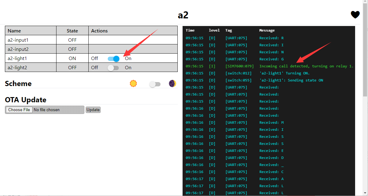

interval:
  - interval: 200ms  # Shorten the interval to reduce blocking time
    then:
      - lambda: |-
          static std::string uart_buffer;
          uint8_t c;
          int count = 0;
          const int max_reads = 10;  // Limit the number of bytes read per interval
          while (id(uart_2).available() && count < max_reads) {
            if (id(uart_2).read_byte(&c)) {
              uart_buffer += (char)c;
              count++;
              // Log each received character (optional for debugging)
              ESP_LOGD("UART", "Received: %c", (char)c);
              // Check if we have received the "RING" signal
              if (uart_buffer.find("RING") != std::string::npos) {
                ESP_LOGI("SIM7600", "Incoming call detected, turning on relay 1.");
                id(relay_1).turn_on();  // Turn on relay 1
                uart_buffer.clear();  // Clear the buffer after processing
              // Clear the buffer if it gets too large
              if (uart_buffer.length() > 100) {

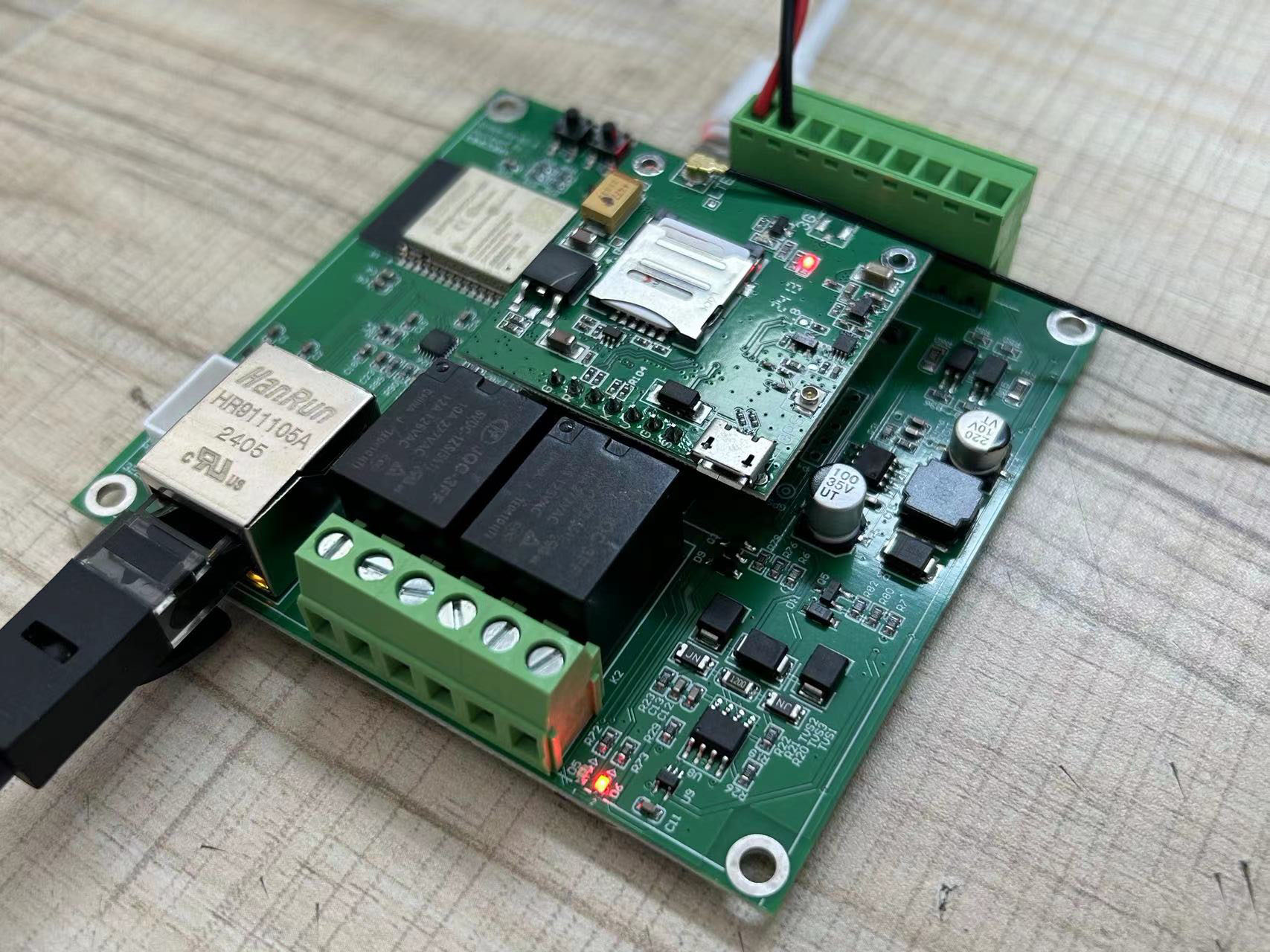

ESPHome yaml file for KC868-A2 board download:
.txt   A2-yaml-sim7600-call-relay.txt (Size: 2.02 KB / Downloads: 318)
