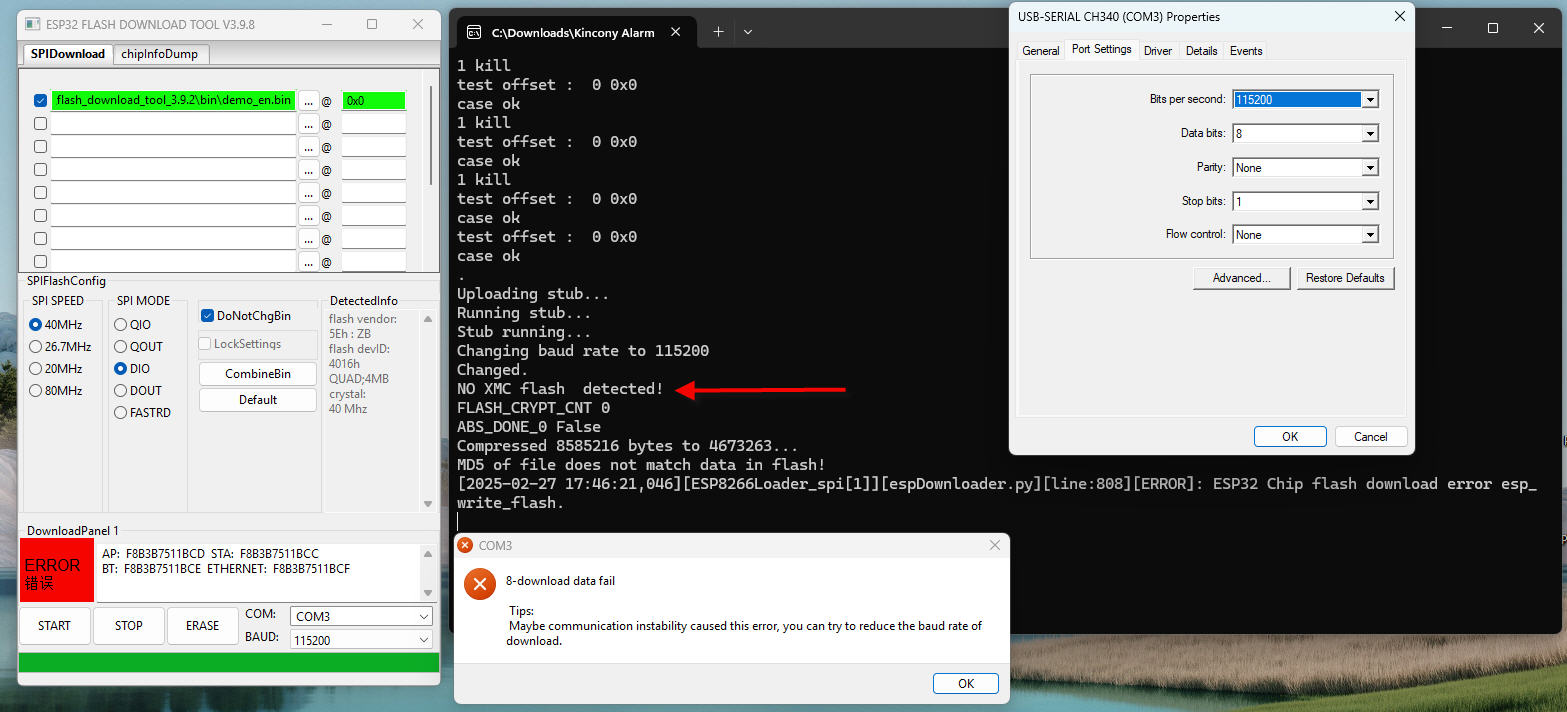

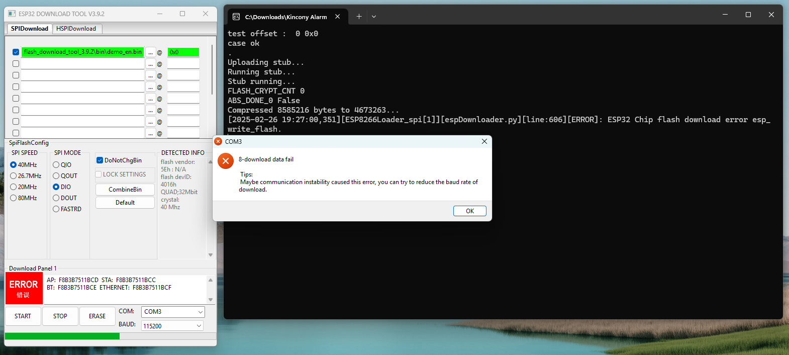

Well I finally got my Windows 11 machine set up and I've had another go at using the Flash Download Tool 3.9.2.
I installed the CH340 USB driver and set the baud rate on Com3 to 115200.
I started the DownloadTool and waited for several minutes before it failed.
What am I doing wrong?

Ok, today I tried a high quality USB C cable connected to a USB 3 port on my PC, this failed so I tried connecting to a USB 2 port on my PC. This also failed. However, I noticed that the progress bar goes all the way to the end before giving the error. The USB ports are set to 115200 bits, 8 Data bits, No parity and 1 Stop bit. Is this correct?
I've also noticed that it displays NO XMC flash detected!

maybe you have select wrong firmware BIN file.  it should be "KCS_KC868_A16_V2.2.10.bin".
i don't know why you are download "demo_en.bin"?  this this file???
