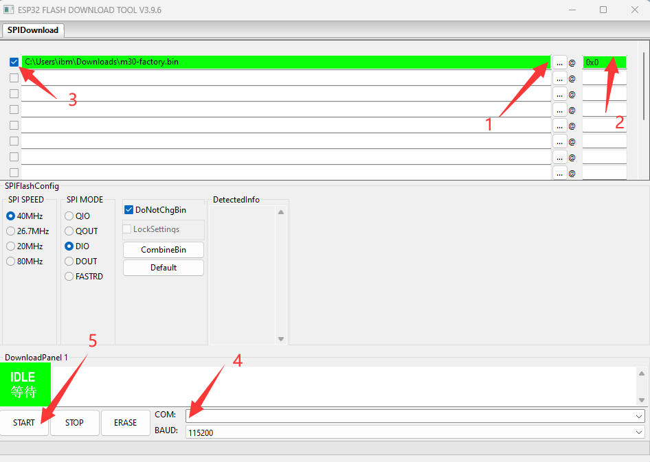

3. use ESP32 flash download tool:
when open tool, chose "ESP32" chip:
then begin do these 5 steps to download firmware:
after you downloaded, connect ethernet cable to your router, re power on of M30 board. now the ethernet work with DHCP mode. you can login with your router to find our the M30's IP address,  then use IP address login by web browser.
