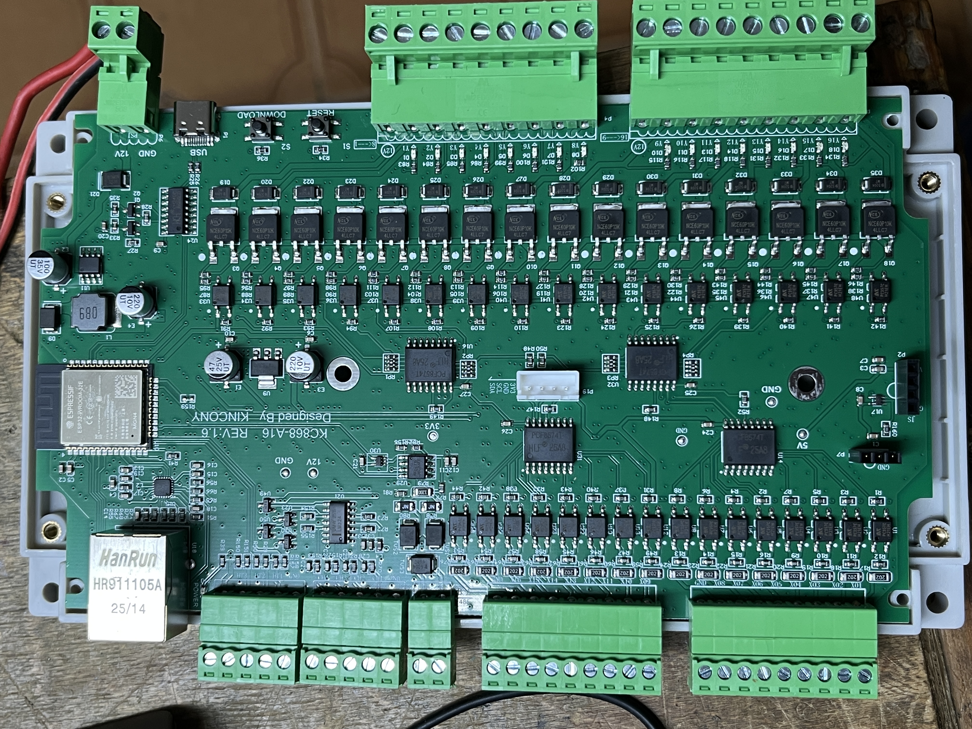

take a photo of your board. do you use A16 or A16v3 board?
(10-26-2025, 07:52 PM)admin Wrote: take a photo of your board. do you use A16 or A16v3 board?
on the card it says v 1.6 however I attach a photo.

if use by KCS firmware, not support PZEM. if you want use them together, suggest you config by ESPHome.
