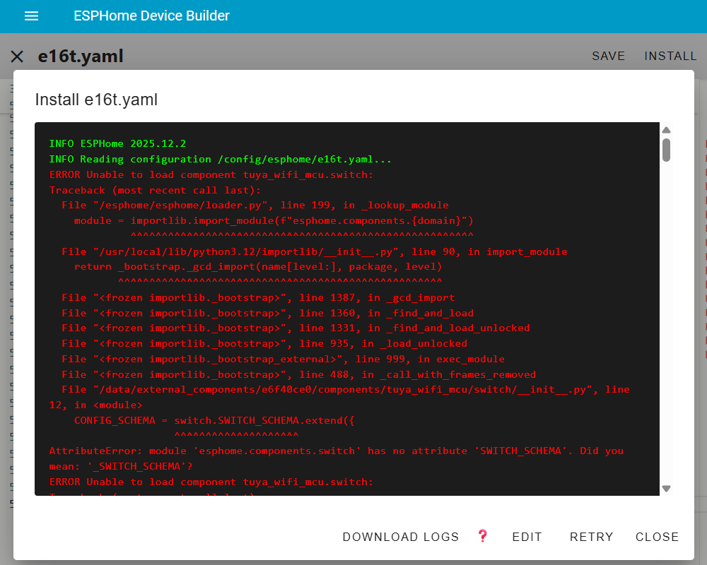

Hello, I need to set ports 1, 2, 3, 4, and 5 to "close" mode when the external device is turned on, and "open" when the device is turned off. I modified the code but I can't install it. I need to get this working so I can buy more.
I am sending the code below.
.txt   new cod 2.txt (Size: 12.61 KB / Downloads: 1)
