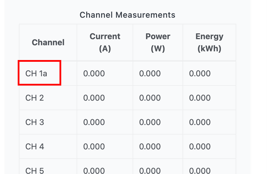

I've attached the pics with another explanation:
I presently have Software Version v3.24.3  (version pic)
I am able to change the label of the channel group name as shown on "group channel name" pic
I would like to change the  labels that are shown on "channel label" pic but I do not see anywhere on how this can be done.
Can you please let me know how I can change these labels on the local N60 web page.
Do you want rename for these CHxx?
These CH name can't rename now. But we will update in next version of firmware.
(04-17-2026, 05:50 AM)admin Wrote: Do you want rename for these CHxx?

1: about "power factor" we will check and later feedback to you.
2: here is new KCS firmware, support rename for every channel and update to home assistant by mqtt auto discovery.
just double click the channel name, you can rename by yourself.
